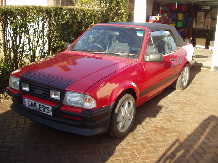

Guest Smiler Posted May 11, 2011 Share Posted May 11, 2011 Same age as mine, I notice yours has the later almost mk4 spec inner wings like mine does, that large circular push-out panel near the front of the near side inner wing if you haven't already guessed is for the mk4 windscreen washer bottle. In fact, I pushed mine out and fitted said bottle. I haven't covered that bit on my website yet (it's woefully behind the car by about 5 years now!) but can send you some pics if you want. The RS1600i look works pretty well with these cars in red and is the look I have gone for with mine. I did try to add a photo of it but the forum didn't like the url extension or something so I've added it as an attachment instead. Prehaps not all that original an idea but to be honest you really aren't likely to pass another mk3 in the street let alone one in the same scheme! Smiler. Quote Link to comment Share on other sites More sharing options...
Guest gavintwopies Posted May 13, 2011 Share Posted May 13, 2011 I take it your car is a carb engine or you are putting the carb engine in? As if your looking for a daily driver and worried about the reliability issue then i would strongly recommend the zetec aproach and if speed is not an issue then your deffo looking at a 1.6zetec i used to get 35mpg from our SI mk3 fezzy and the cab would not be far behind or like i did fit a 1.8 zetec this returns 30-33mpg with loads more power to boot and reliability has gone through the roof car is driven 7days a week 25miles a day minimum. Also loving the rs1600i splitter with black bonnet and boot but bumpers are a deffo, even pc plod might have summit to say about that too??? Quote Link to comment Share on other sites More sharing options...
