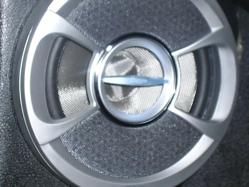

Admin Paul Posted March 5, 2007 Author Admin Share Posted March 5, 2007 Ok just fitted the new internal speakers - 5 1/4 Infinity Kappa Componets in the front and 4 inch Infinty Kappa coxials in the back, didnt want to cut the pods. Also new back is fitted in boot. The pictures for some reason make the carpet look dirty!!! ITS NOT LOL!!! Link to comment Share on other sites More sharing options...
Admin Ollie Posted March 5, 2007 Admin Share Posted March 5, 2007 Ok just fitted the new internal speakers - 5 1/4 Infinity Kappa Componets in the front and 4 inch Infinty Kappa coxials in the back, didnt want to cut the pods. Also new back is fitted in boot. The pictures for some reason make the carpet look dirty!!! ITS NOT LOL!!! paul have you got space behind the back upright or is the mdf tight to the seat Link to comment Share on other sites More sharing options...
Admin Paul Posted March 5, 2007 Author Admin Share Posted March 5, 2007 The new backing board fits against the cross bar section, boot side. So i have approx 6 to 8 inchs of wasted space between the back of the mdf and the back seats. I was going to use this space to hide the cables etc, also can fit my windbreak in here when not in use. You can access very easily when you drop the rear seat. Paul Link to comment Share on other sites More sharing options...
Guest Keith Posted March 5, 2007 Share Posted March 5, 2007 The new backing board fits against the cross bar section, boot side. So i have approx 6 to 8 inchs of wasted space between the back of the mdf and the back seats. I was going to use this space to hide the cables etc, also can fit my windbreak in here when not in use. You can access very easily when you drop the rear seat. Paul Same as I did with mine, hides all the wires and also now keeps the roof pump out of the way, mind you cant get to any of it because of the 6x9's in the rear pods. Link to comment Share on other sites More sharing options...
