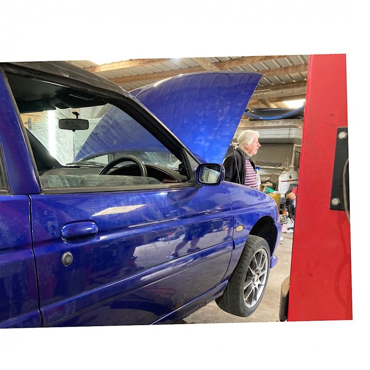

After 4 years of sitting on my drive breaking my heart of not being used it’s going into the garage for a revamp.
I will be putting new sills, of which I can’t find. So will be cutting new ones for a three door escort to fit!
New hood to be ordered too , anyone recommend a good supply please email me, mohair black wanted.
 Well be cutting out the rusty battery tray too and replacing with new.
also I have a set of Ford wheels to put back on her, get these ugly alloys off lol
The doors have rust on the bottom too, so hoping to cut and repair these if money and time allows.
Engine is my main worry but hopefully luck is on my side here !
It’s a 130bhp in blue , year 1995
if your interested I will post pics and info , updates
