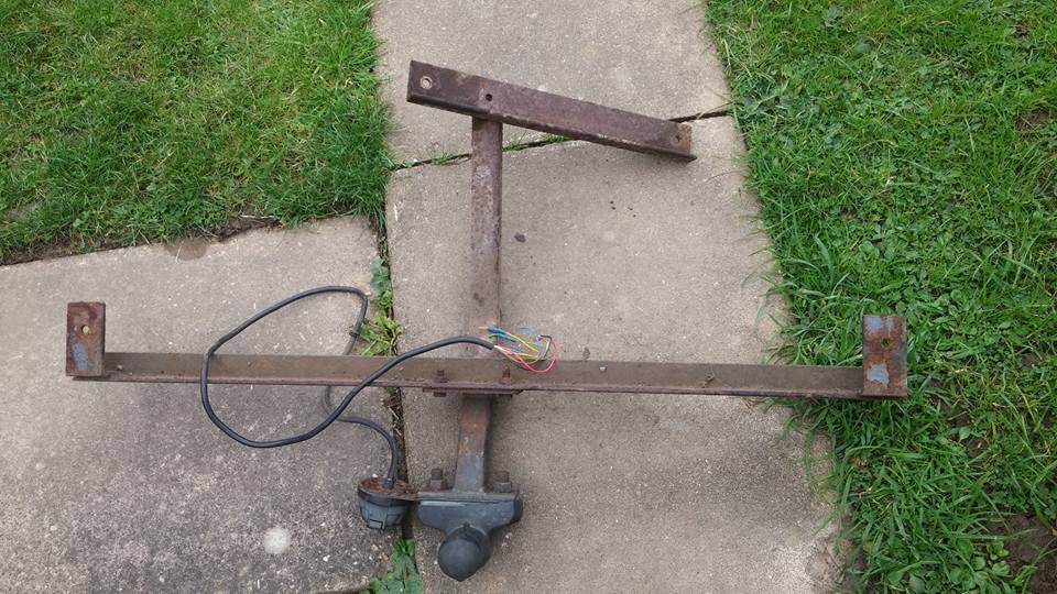

Guest Glenn65 Posted February 3, 2016 Share Posted February 3, 2016 A chap on the Facebook page has offered me this one for £25 plus postage saying it's off a mk4, do you think it looks right? John do you know if yours looks in better nick? Link to comment Share on other sites More sharing options...
Guest Glenn65 Posted February 3, 2016 Share Posted February 3, 2016 Seen this on eBay- http://www.ebay.co.uk/ulk/itm/270933620731 If it's only the rear valance that's different, technically it should fit? This looks like the towing are can be removed. Link to comment Share on other sites More sharing options...
