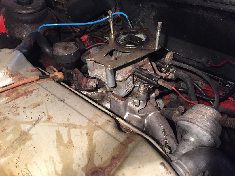

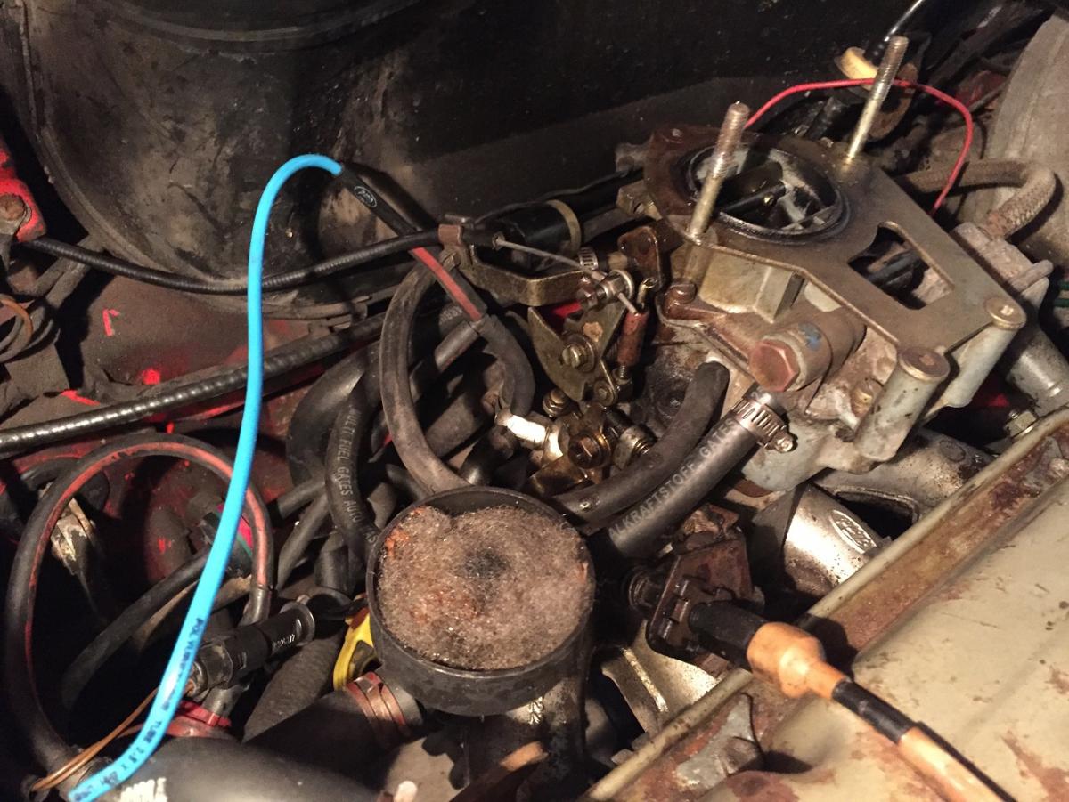

Guest Glenn65 Posted February 16, 2015 Share Posted February 16, 2015 Here are a couple of the carb on the car... Quote Link to comment Share on other sites More sharing options...

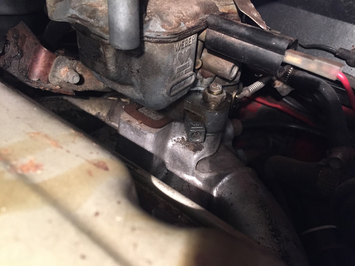

Guest Glenn65 Posted February 16, 2015 Share Posted February 16, 2015 Quote Link to comment Share on other sites More sharing options...

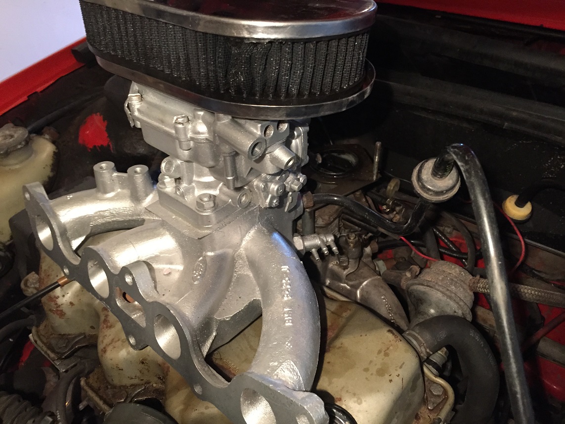

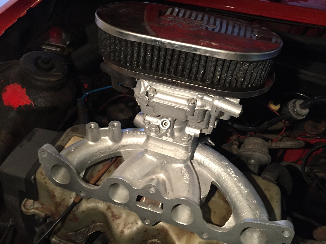

Guest Glenn65 Posted February 16, 2015 Share Posted February 16, 2015 and this is the carb I picked up.... Quote Link to comment Share on other sites More sharing options...

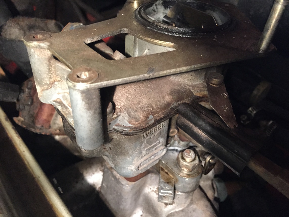

Guest Glenn65 Posted February 16, 2015 Share Posted February 16, 2015 Sorry for bombarding post with pic's still getting to grips with the site.... The car runs OK, but rich, on looking closer at pics, I think the "tube" on the side was the wrong one, and can see a smaller square "tube" at the bottom that may have a small screw in it. I'll have a muck about with this, but would like to get the twin choke carb fitted at some point. I've also a chrome rocker cover to go on as I start to tidy up engine bay. I'd be interested in finding out more though regards the NOS card in your local stealer.... Quote Link to comment Share on other sites More sharing options...
Ian71 Posted February 16, 2015 Share Posted February 16, 2015 Has the carb got any numbers on it anywhere,and also where it says weber where does it say its made ? i.e spain Italy. Quote Link to comment Share on other sites More sharing options...
Guest Glenn65 Posted February 16, 2015 Share Posted February 16, 2015 Hi Ian, thanks for your time with this. It says made in -then a blank, it has the numbers 34 IBF on it and the plate attached also has this along with 016 6 on it. The top face has carburatore weber on it but that's all that's on it. On a plus I think I found the mixture screw, it was out about 7 or 8 turns, so went back to basics and screwed it in and took it back out 2.5 turns. Upped the idle to get it to sit smooth and seems to rev smooth also. With mine being a GL there is no Rev counter so set by ear for now but will get one of those clip on timing/ Rev counter guns to get it right Quote Link to comment Share on other sites More sharing options...
