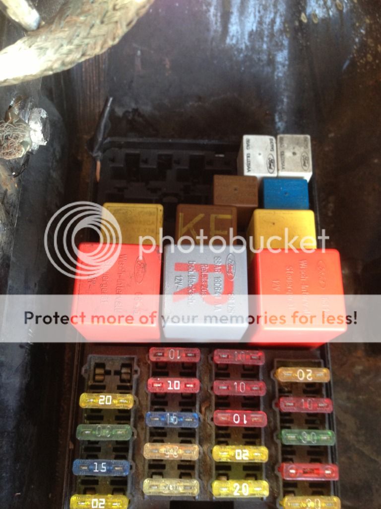

In my fuse box the fuel relay is normally pink but in mine there is no fuel relay does anyone know the part number for it the one I believe is the fuel relay is actually red
If its a EFI it will be a small yellow one under the dash, took me ages to find mine lol
If you go on your back near the peddles and look up behind the dash with a torch you will see em, there should be 4/5 (Diff colours/sizes) of em on a rail, the rail comes off if you use a stubby philips screw driver bit fiddly tho, or you find that most of the time they are just zip tied up there or dangerously! like mine - hanging down freely lol
