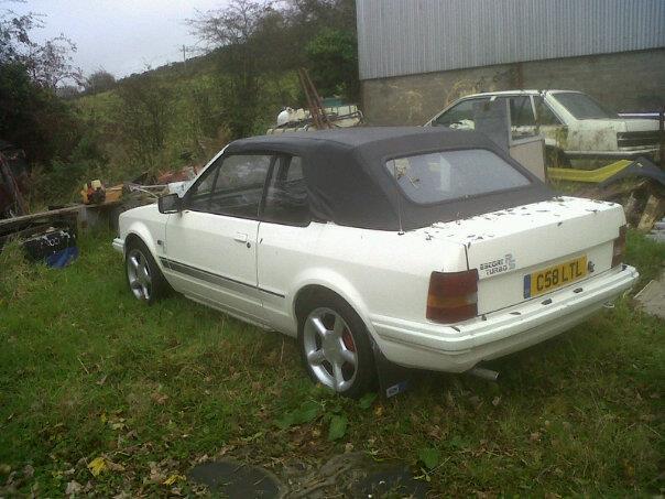

has any1 come across these mixing oil and petrol?? any advice would b great, flushed it a few months ago did no more than 100mile since oil stinks of petrol again
  • Admin
yeah i have you will find the jet is probably stuck open on the metering unit .
when i got my cab back on the road i had big probs with mine kept filling the sump up with fuel .... neat fuel
worth trying another if you can or getting it refurbed and cleaned
