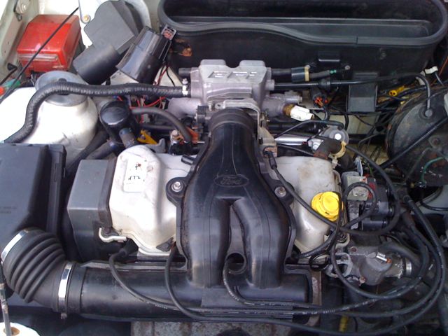

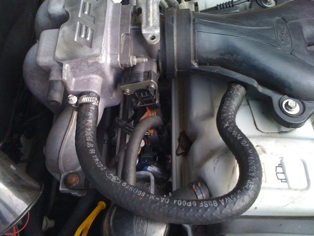

Guest bigburger Posted March 1, 2010 Share Posted March 1, 2010 Hi i have had my car for a few weeks now but have always had a problem with this blasted hose, i am not a mechanic and haven't got a clue and here in belfast no one wants to know. Where does it go, or is there something else missing ? Any help would be great. Quote Link to comment Share on other sites More sharing options...
Guest bigburger Posted March 1, 2010 Share Posted March 1, 2010 If i do this which seems natural to the shape of the pipe, the car hits about 7000rpm and just sits there revving out.... I haven't got a scooby doo... cheers Quote Link to comment Share on other sites More sharing options...

Guest mossop1 Posted March 1, 2010 Share Posted March 1, 2010 well if you mean that big pipe that comes off the inlet i would say thats wrong as cant see why it would be like that at all i would sujest as to were it is looks like it would some how go on the breather system but im sure one of the mk4 efi guys/gals could tell you exactly. Quote Link to comment Share on other sites More sharing options...
Guest suffolk04 Posted March 1, 2010 Share Posted March 1, 2010 doesnt the airbox look wrong? i;m thinking the idle speed control valve is behind the suspension turret, so it goes..... pipe from manifold to control valve, pipe from control valve to air box, then airbox back to the black inlet tube. this might be wrong lol, but i know i have the airbox for this system, and you have the one for mine. Quote Link to comment Share on other sites More sharing options...
Guest shaun Posted March 1, 2010 Share Posted March 1, 2010 hi not to sure but from what i remember it goes to the air box and the place were you have it was blanked off....hope this helps Quote Link to comment Share on other sites More sharing options...

Guest shaun Posted March 1, 2010 Share Posted March 1, 2010 hi what suffolk has said is right there no idle control valve? is this on your air box???on the xr2i the changed the idle control valve and moved off air box to the rear of inner wing area..... Quote Link to comment Share on other sites More sharing options...

allblue Posted March 6, 2010 Share Posted March 6, 2010 You have a mismatch of parts there. In summary, there were three variations of the EFI airbox design. The airbox you currently have on your car is for cars where the Idle Speed Control valve (ISCV - silver cylinder shaped device with either 1 or 2 hoses coming off it) is directly attached to the inlet manifold (the silver aluminum bit with the 'EFI' logo on). Like previously mentioned, there does not seem to be an ISCV attached to your car. Can you see one anywhere in the engine bay? The hose you originally talk about, attaches to the ISCV at the disconnected end. Another hose should then run from the ISCV direct to the airbox. Hope this helps. Quote Link to comment Share on other sites More sharing options...
Guest bigburger Posted March 6, 2010 Share Posted March 6, 2010 no i can't seem to find an idle control valve, in that case is the air box wrong type for my car ? Steve Quote Link to comment Share on other sites More sharing options...
Guest bigburger Posted March 6, 2010 Share Posted March 6, 2010 is it possible you could me a pic of it ? Quote Link to comment Share on other sites More sharing options...
Guest suffolk04 Posted March 6, 2010 Share Posted March 6, 2010 (edited) from the 2nd picture it doesn't look like the iscv would fit onto the inlet manifold, the design looks different. the iscv is behind the turret, the set up is little different becasue of the cone filter, but shold be a little clearer as to where the pipes go i can't remember where i got this picture from, but if its someones on here, sorry for using it, but thanks Edited March 6, 2010 by suffolk04 Quote Link to comment Share on other sites More sharing options...
