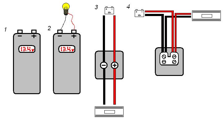

i wired the positive to the amp next to it, the negative to a different earth than my amp one.
shud i have wired the negative to the same earth as my amp?
please help!!
p.s. i charged the cap 1st also :wacko:
