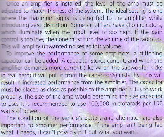

i know how a capacitor works and what it does, what i dont know is how you would go about speccing the right one for a particular installation....where did you get 2 farads from???

There is a guide in one of my books about the Watt to Farad ratio, i'll have a look tomorrow for you mate and try to scan the relevent page for you !!!Thumbs_up.gif

There is a guide in one of my books about the Watt to Farad ratio, i'll have a look tomorrow for you mate and try to scan the relevent page for you !!!post-4076-1199320199_thumb.gif
Thanks Charlzy, the theory behind these things I find a bit confusing, so I dont wnat to spend money on something Im not to sure I beleive in at the mo. Is the book specifically for car hi-fi, or is it electrical theory, if its just about car amps/speakers I am interested in reading it, as I cannot find a good guide. If its theory, Ive already got that mate thanks.

I got a hand written guide of my mate years ago but I treated myself to a HAYNES ICE MANUAL !!! :biggrin:
Its spot on, it explains all the techno-babble and I found it very helpful !!! :biggrin:
The Ratio is to use 100,000 Micro-Farads per 100 Watts of Power, so if you use a 1000 Watt amp you should get a 1.0 Farad Power Cap, 1.2 will be better, I have 3200 Watts of PURE MUSIC POWER, so I just went for 5.0 Farads !!! :banana_dance:
I scanned a couple of pages for you Mick, if you lived a bit closer I would lend it to you lol !!! :happy001:
