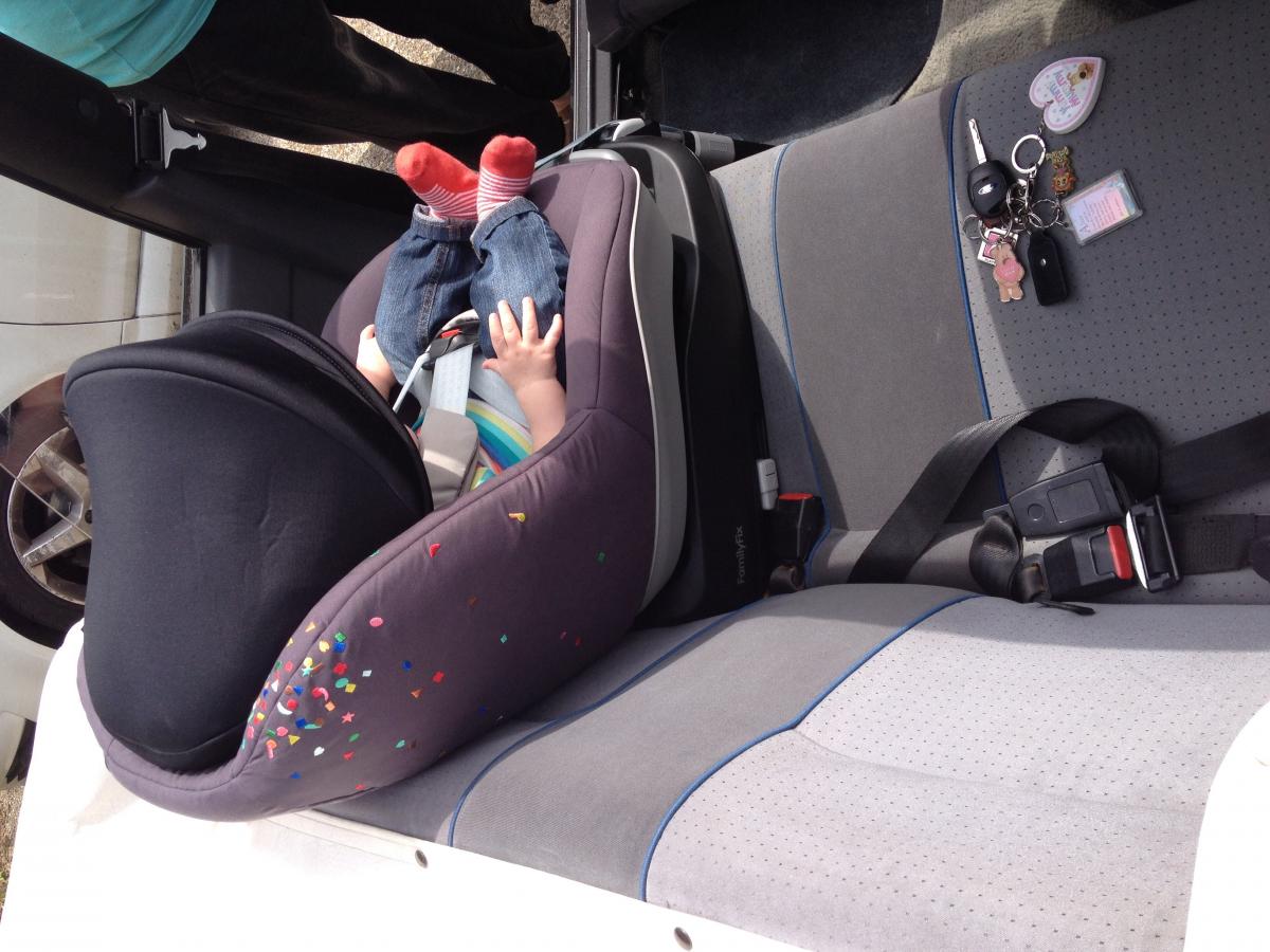

so after fitting the isofix bracket in the st focus our daily drive I thought I would try something
bracket brought from fords
isofix fitted to the focus
before fitting the bracket to the focus I thought I would try it and see if I could bolt it through the floor of the escort but hey presto the bracket holes line up to the original rear seat belt fixings so no drilling required
isofix bracket fitted to the cabriolet
now for obvious reasons while Nicholas is traveling in the back the roof will stay up due to safety reasons and of course the intense heat we have here in England lol
but once the next seat is purchased which is the pearl and sits forward facing :>)
the base fitted
