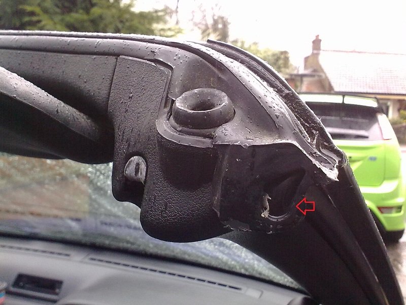

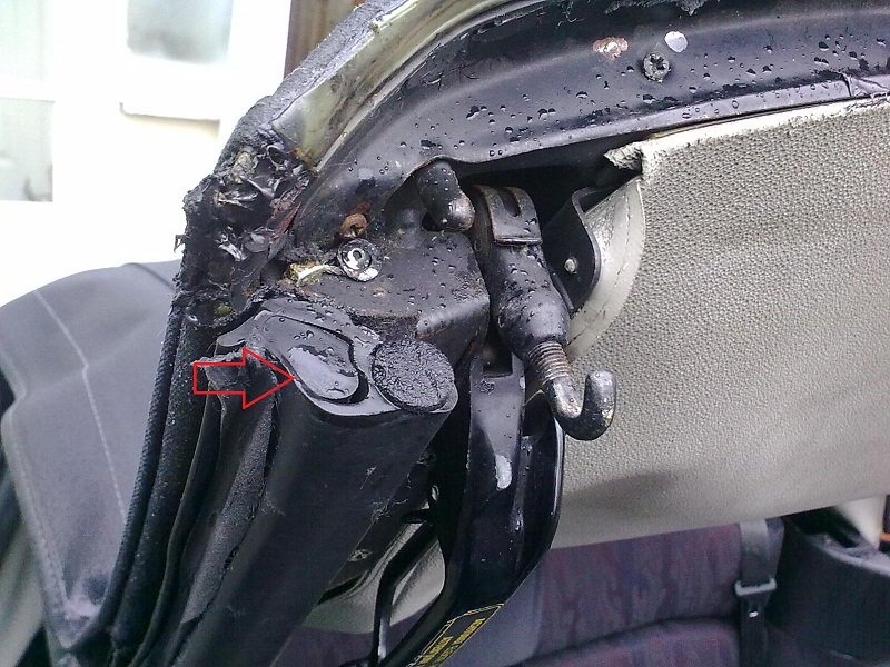

The pic below shows where water seems to come into the roof seal via the front. This triangular block appears to allow water in as it is not fixed. I had previously put sillicone sealant, but it didnt last at all. I have now bought Stormsure 5g on ebay. This is also good for split roofs.

When I did use this, not shown in any of the pics, have to take some of it done. I left it for 6 hours before closing the roof.
Water travels further along the triangular block in the seal on the roof itself. It is also worth sealing this up with stormsure as the water can go further back near the pillar.

This is the passenger side seal that leaks far more than the drivers side at the time. Took this pic when it rained and you can see the water coming through. It was sometimes so bad that it would run further back along the seal and also leak out just before the b pillar. This soaked my rear passenger footwell to a puddle pond.
Blue arrow shows where water comes into the triangular block. There is a normal exit for this by the bottom windscreen door A pillar. I had to get a syringe with hot car wash to pump it down here to clear it out of tree sap etc to allow better drainage. The green arrow shows where it was exiting into the car itself. I had even get felt adhesive pads to try to stem the leak, but it didnt work. Ended up removing them after the pics were taken. And glued the triagular block behind it with stormsure.
