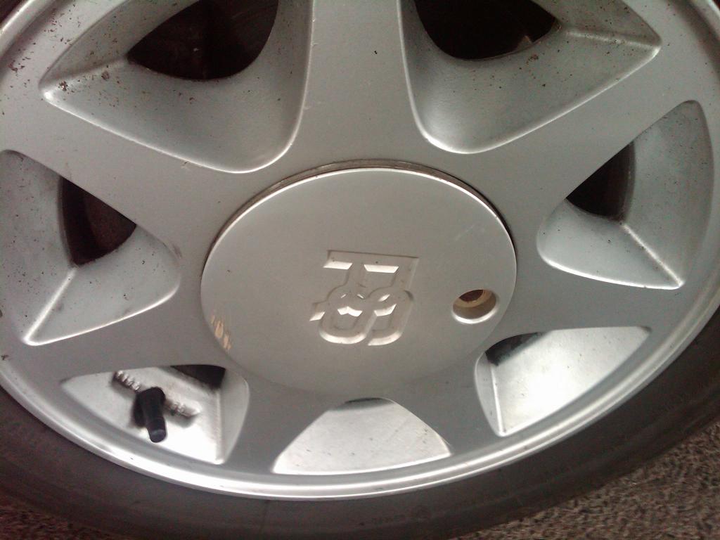

Guest mic Posted August 13, 2011 Share Posted August 13, 2011 hi ive put some RS alloys on the cabby but the centre caps dont sit flush. the wheels are on ok, all level and should drop off and the centre caps are screwed on but they stick out and it looks naff. what do i need to make em flush? cheers Quote Link to comment Share on other sites More sharing options...

Guest mic Posted August 13, 2011 Share Posted August 13, 2011 heres a picture Quote Link to comment Share on other sites More sharing options...
Guest Cooderkey Posted August 13, 2011 Share Posted August 13, 2011 Looks like a mis-match to me. If that was my wheel, I'd have cleaned it. No one should be allowed to post dirty pictures on the family site. Quote Link to comment Share on other sites More sharing options...
Guest mic Posted August 14, 2011 Share Posted August 14, 2011 ah ok will see if i can source other insidey bits. its not dirty if you look at if from a distance, or look at the picture when its really small Quote Link to comment Share on other sites More sharing options...
gingergman Posted August 14, 2011 Share Posted August 14, 2011 you say the center caps screw on? Quote Link to comment Share on other sites More sharing options...
Guest Lee81 Posted August 14, 2011 Share Posted August 14, 2011 Your missing the locking screws on the caps which are virtually impossible to find these days. so find some different caps. be prepared to spend though as i saw a set that go on that type of wheel a few months back on ebay for a cool £150 Quote Link to comment Share on other sites More sharing options...
Guest adamk Posted August 15, 2011 Share Posted August 15, 2011 (edited) looks like you have 15 inch RS wheels, but 13 inch RS 7 spoke center caps. The center cap on the 13" version are thicker and would stick out like that are the ceter covers made from plasic, if so there of 13"'s Edited August 15, 2011 by adamk Quote Link to comment Share on other sites More sharing options...
Guest Alanman Posted October 22, 2011 Share Posted October 22, 2011 i know this is over 2 months old sorry but I had a problem like this once and it was down to the locking wheel nuts. They were bigger than the standard nuts and didnt let the cap sit flush. Quote Link to comment Share on other sites More sharing options...

Guest shaun Posted October 24, 2011 Share Posted October 24, 2011 The screw's for the centre cap's you can still get from ford £30 and you get the key aswell cos just bought some for my 15" softlines Quote Link to comment Share on other sites More sharing options...
