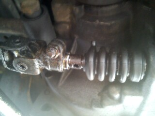

Guest farby Posted April 10, 2011 Share Posted April 10, 2011 Hi Does any1 know how to change the Oil Seals on the back of the gearbox where the selector rod goes into.....? See attach. Where do i refill the gearbox...is it from the black cap that comes of the top ...? Quote Link to comment Share on other sites More sharing options...

Guest suffolk04 Posted April 10, 2011 Share Posted April 10, 2011 should be the same as the mk4, undo the nut, disconnect gear rods, take off rubber boot, then use a pair of mole grips to grip the seal, gentle tap with hammer, its out. to fit find a socket to fit against the new seal, lighly tap with hammer until it sits in nicely. pretty sure its the samr gearbox as escorts/fiesta and ka's. Quote Link to comment Share on other sites More sharing options...
