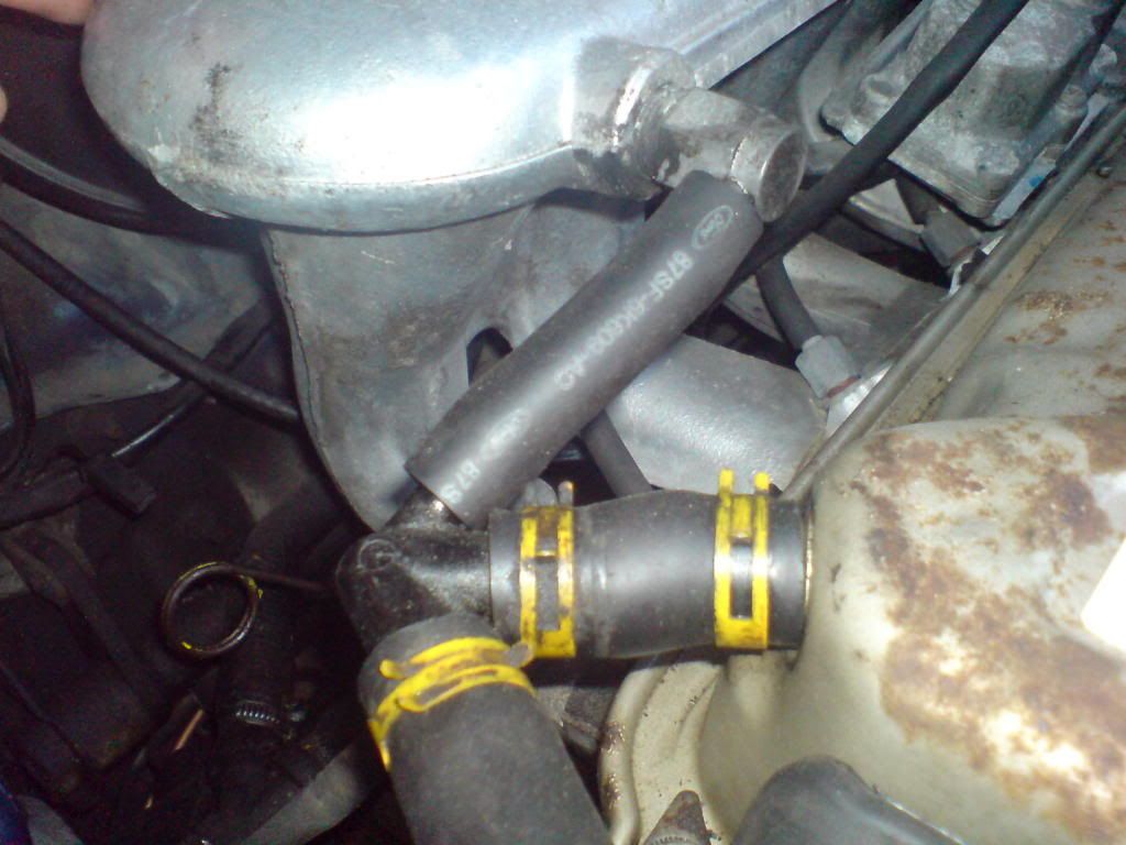

Guest anton1 Posted May 25, 2010 Share Posted May 25, 2010 Well I got home and put her on the ramps to have a look...wiped everything and seemed to be coming from above the gearbox and on further investigation found what was happening. Somehow there's oil coming from the rocker cover breather hose into the air box, through the brand new filter! and then dripping through the base of the air box as there's a hole been drilled in it. Then it's dripping onto the gearbox and driveshafts and spraying everywhere! Never would have expected this! Does anyone know why the oil is leaving the rocker like this????? Quote Link to comment Share on other sites More sharing options...
RobMk4TwinCarb Posted May 25, 2010 Share Posted May 25, 2010 Mine hoons oil out of the breather, but on the opposite side of the bay as it's efi. I guess it's fumes coming from the crankcase breather into the rocker and then out of the filter..only a guess and no idea of cause. Quote Link to comment Share on other sites More sharing options...
