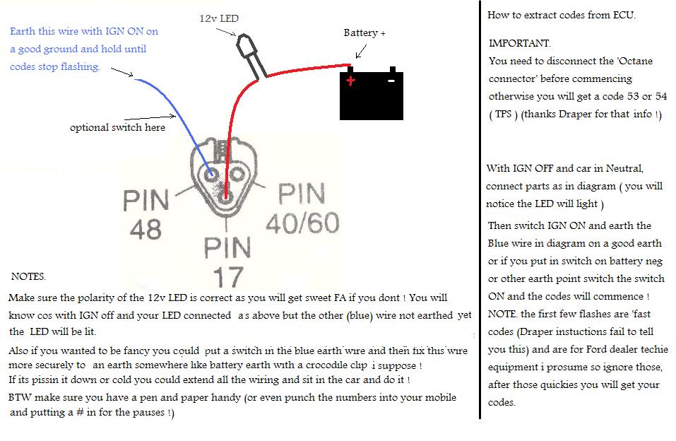

Anyone tried one of those draper code readers (3 pin) or can i do it myself with a bit of wire and an LED ?

Anyway, tried what it said on the above site and it works !
I extraced codes from ecu and although i dont have the exact escort eeciv ecu codes i think there probably the same as Sierra/Scorpio (same ecu) and think i have a faulty throttle position sensor.
i'll report back if replacement TPS cures my probs and then i'll do a write-up on how to do it for anyone whos interested ?
Guest macabrio
I'm now not sure wether the above site is entirely correct in its wording of the code meanings and is a bit vague in general .
I have since found this site http://www.corral.net/tech/maintenance/eec...okoer.html#koeo which appears to be more correct on the preceedure on decifering the codes.
Still trying to suss them out yet but this site explains 'my' findings a bit better however the wiring section of the BTINTERNET site is correct and worked for me in getting some codes/flashes from my homemade LED setup if you want to experiment ....BUT DO FIRST PM ME OR POST HERE to request a better wiring diagram/explanation of how i did it (not hard ,just 3 bits of wire and a 12v LED !) AS I WILL NOT BE HELD RESPONSIBLE FOR BLOWN ECU'S !
BTW those Draper or Gunson code readers for £15 on ebay (or ive seen them for ridiculous figures of i think £140 !!!!) ARE BASICALLY JUST A SWITCH AND AN LED AND ARE DOIND EXACTLY THE SAME THING AS I'M DOING ABOVE BUT FOR LESS THAN 50P ! :teu26:

Cheers for taking an interest ! I have been doing some more delving into this and have done this sort of delving before on an Astra GTE , Vectra and Citroen XM ive owned in past ! (works with them too but different wiring)
I now have the definative instructions on how you do this because ( like i done before on other cars ) i tracked down the official Draper instructions in a PDF file !
This has concise, easy (ish!) to follow ins and all the 2 and 3 digit codes !
If you like i'll knock up a wiring diag in an art program then i can PM it you along with the Draper PDF ?
I will also post the Diagram up here shortly.
Hopefully this can become a 'Sticky' for anyone wanting to try this instead of going to the stealers and being charged £££££'s (usually £40-80 ?) !!!

Also my TPS fault ive been getting could be a red herring after all this as the Draper ins say if you dont disconnect the Octane connector before fault code reading it will come up with code 53 which is TPS low ! :throw:
If thats the case (have 2 try tomoz cos shit weather tonite) them afaik i'm getting the 'all clear' code of 11 :wacko:

Big thanks for the code reader diag's sure it will help :icon_salut_gb:
