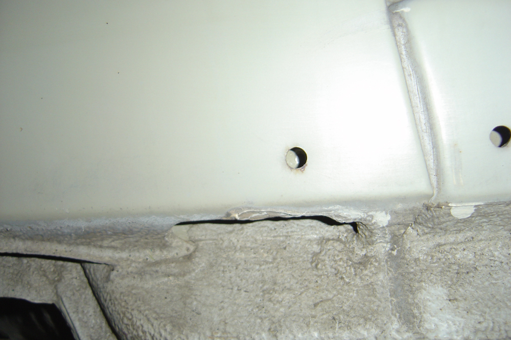

Guest suffolk04 Posted July 7, 2009 Share Posted July 7, 2009 booked my mk4 into a bodyshop, gave them genuine ford wings. but they won't fit!!!!!! it all matches up under the bonnet, but doesnt fit on the sill because of a piece of metal at the bottom of the wing touching the sill. Anyone know what to do? or had this problem? gotta go back to the bodyshop tomorrow. Quote Link to comment Share on other sites More sharing options...
Guest dee1orean Posted July 7, 2009 Share Posted July 7, 2009 Seems simple to me, cut away the piece of metal causing the obstruction. If they are any kind of decent bodyshop then they'll be able to make the wings fit. Jez. Quote Link to comment Share on other sites More sharing options...
Guest suffolk04 Posted July 7, 2009 Share Posted July 7, 2009 thats the plan, but what is the piece of metal there for? the guy didnt want to bodge it on, without me saying so first, but i was curious on why that piece was there and wouldn't fit with it on. have you had/fitted any? Quote Link to comment Share on other sites More sharing options...
RScab Posted July 7, 2009 Share Posted July 7, 2009 The wings where cut before fitment buy the manfacturer if you need a pick let me know I have a New Genuine mk4 shell still in factory primmer so can be seen as it was before paint hope this helps Quote Link to comment Share on other sites More sharing options...
Guest suffolk04 Posted July 7, 2009 Share Posted July 7, 2009 The wings where cut before fitment buy the manfacturer if you need a pick let me know I have a New Genuine mk4 shell still in factory primmer so can be seen as it was before paint hope this helps so would the piece need cutting or bending? Quote Link to comment Share on other sites More sharing options...
RScab Posted July 7, 2009 Share Posted July 7, 2009 needs to be cut m8 due to the cab under body supports Quote Link to comment Share on other sites More sharing options...
RScab Posted July 7, 2009 Share Posted July 7, 2009 Pic m8 Quote Link to comment Share on other sites More sharing options...
Guest suffolk04 Posted July 7, 2009 Share Posted July 7, 2009 brilliant thank you, thats cheered me up will be going to the bodyshop with a big smile on my face, holding that picture. thanks again Rscab, all the best with the mk4 Quote Link to comment Share on other sites More sharing options...
Guest suffolk04 Posted July 14, 2009 Share Posted July 14, 2009 all sorted, i asked him how he did the wings, he said he left the metal on, and wielded it all the the sill, very happy with the end job, but no so happy with the history of the car, drivers wing doesn't fully line up because the cars had a bump in the past. Quote Link to comment Share on other sites More sharing options...
