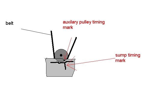

Guest markeyboy Posted March 15, 2009 Share Posted March 15, 2009 as badger said, there is a notch on the bottem pully ( you need to take the plastic cover off to see this) which you need to line up with a mark on the sump, if the timing is correct you should be able to slot a bar into the milled slots at the other end of the cam shaft (5 6 or 7 mm bar i cant remember) i may have aq crude paint drawing, ill try 2 find it Link to comment Share on other sites More sharing options...
Guest markeyboy Posted March 15, 2009 Share Posted March 15, 2009 there ya go Link to comment Share on other sites More sharing options...
badger Posted March 15, 2009 Share Posted March 15, 2009 as badger said, there is a notch on the bottem pully ( you need to take the plastic cover off to see this) which you need to line up with a mark on the sump, if the timing is correct you should be able to slot a bar into the milled slots at the other end of the cam shaft (5 6 or 7 mm bar i cant remember) i may have aq crude paint drawing, ill try 2 find it its a 5mm bar that'll slot in nicely when the pully is on the marker if the timing is right. Link to comment Share on other sites More sharing options...
