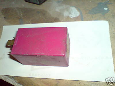

hello again everyone, could anyone tell me which relay is for the fuel pump and were i will find it please?
mk4 xr3i, f reg.
i believe this is the bugger stopping the car from working,
thanks
max
nah mate on a f reg mfi engine the relay is pink and is found under the dash on the drivers side there is generally 3 or 4 relays up there and the fuel relay should be the biggest one of them hope this helps thanks eddie.
Guest steelcabby
ALSO IF ITS AN AFTER MARKET ONE, IT WILL MOST PROBABLY BE BLACK. BEST THING TO DO IS TO FIND THE RELAYS UNDER THE DRIVERS SIDE DASH PULL THEM ALL DOWN AND CHECK WHAT THE COLOUR OF THE FEMALE PLUG IS THEY SIT IN. THEY ARE ALL COLOUR CO-ORDINATED.
PINK/PURPLE------PINK/PURPLE
GREY-----GREY
GREEN------GREEN
ETC ETC. IF THERE IS NO PINK RELAY IT COULD MEAN ITS BEEN CHANGED TO A BLACK ONE, SO CHECK THE COLOUR OF THE PLUG ITS CONNECTED TO AND THAT SHOULD BE PINK OR PURPLE IN COLOUR
Think you;ll find that what i said,
to the right hand side, as you look at the wheel under the dash,
Ive got 5 relays sitting on a shelf, ill send ya 1 up for a try, that way if it dont work ya aint lost owt hey :wink:
