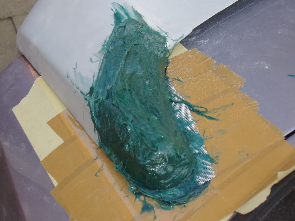

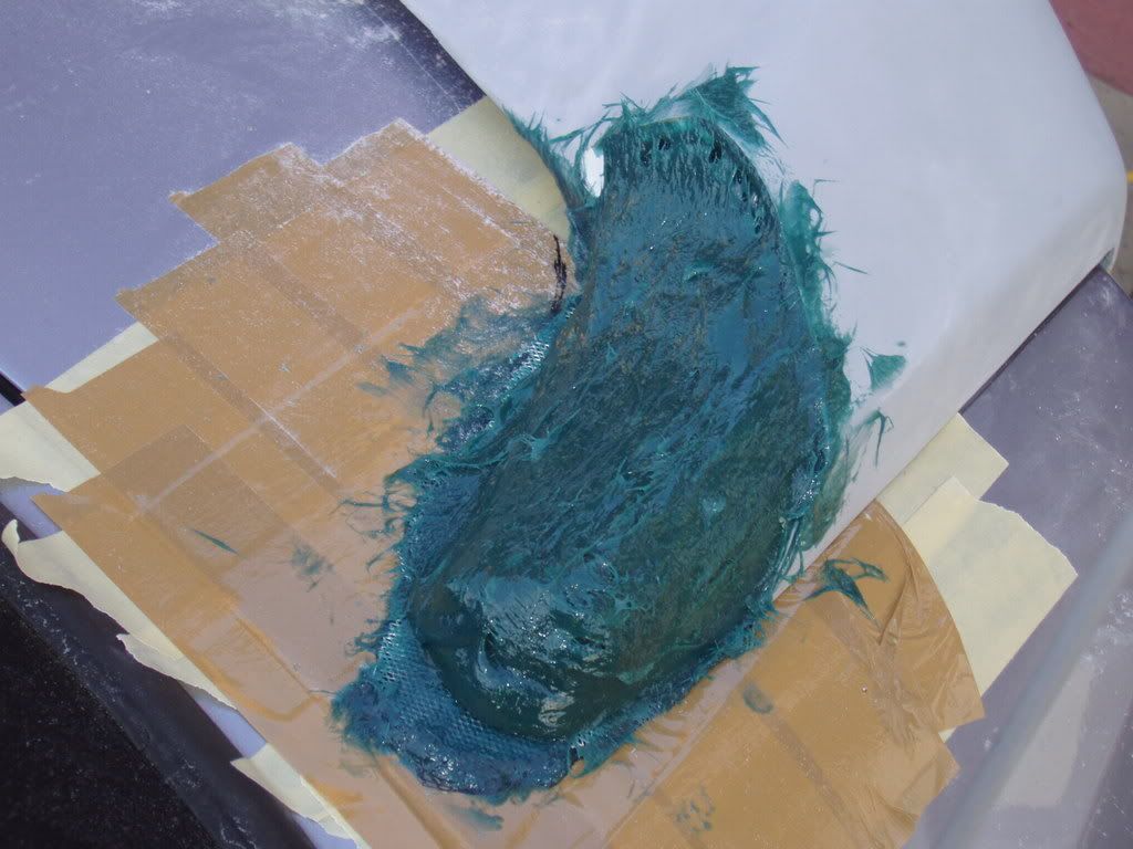

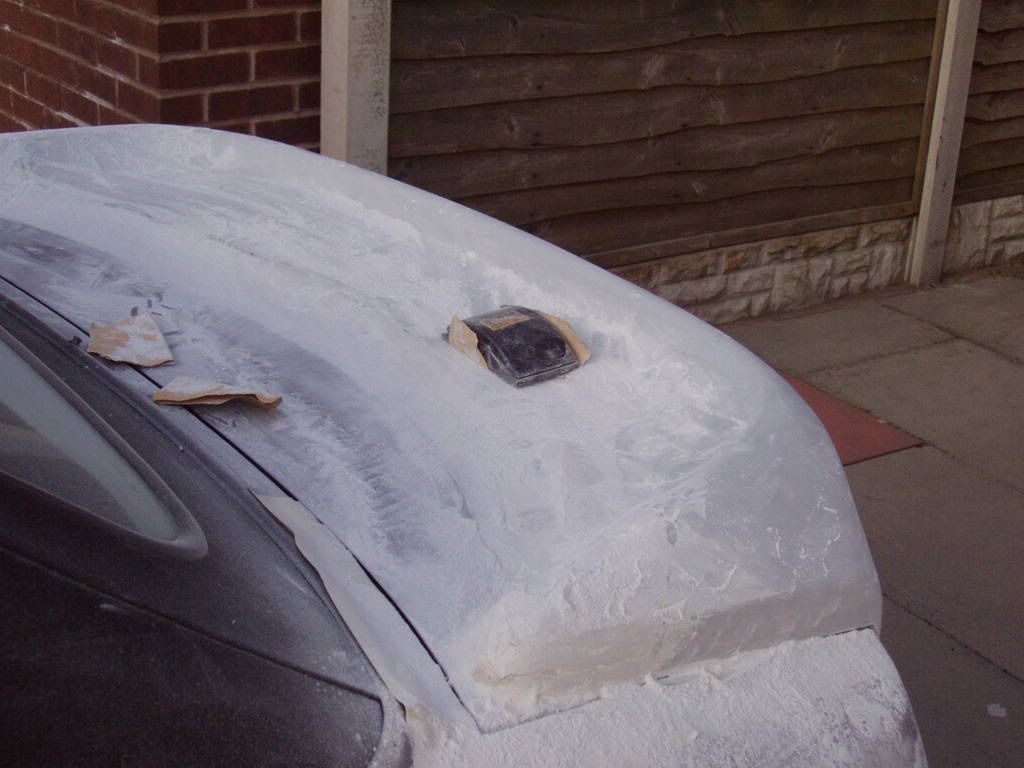

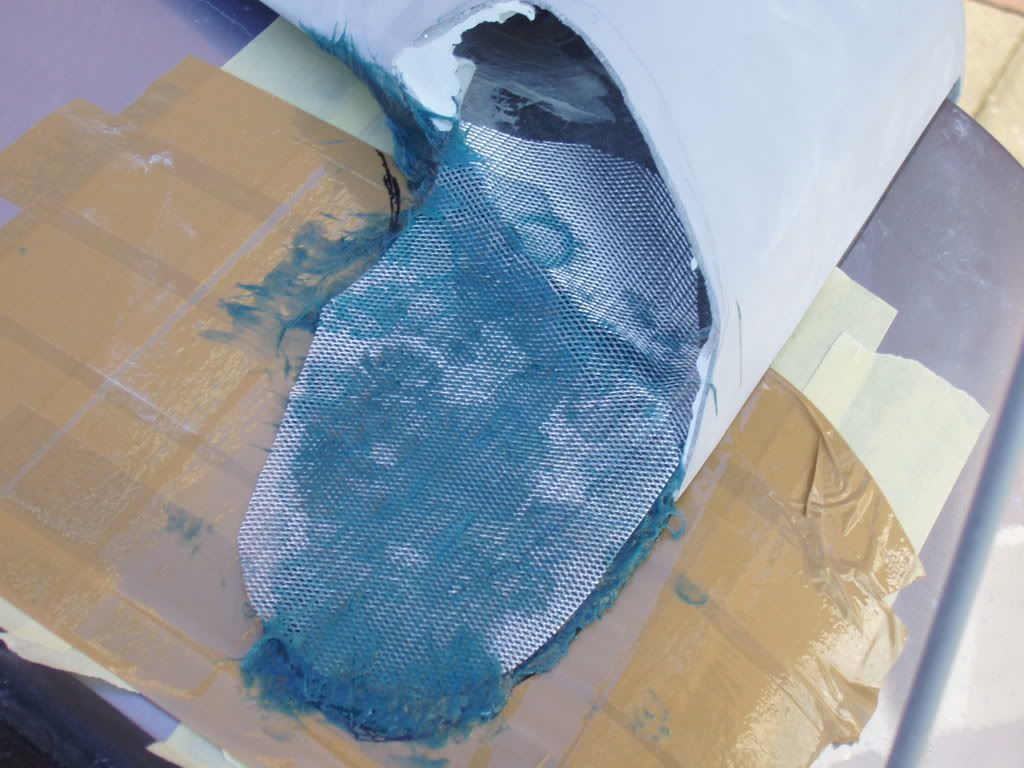

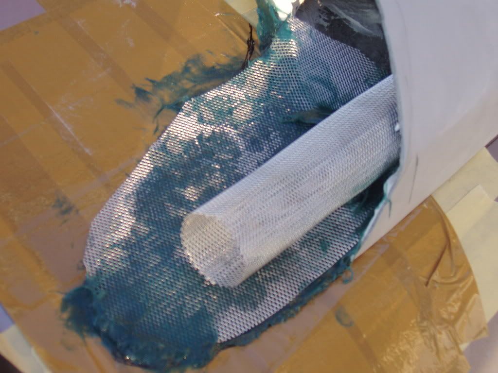

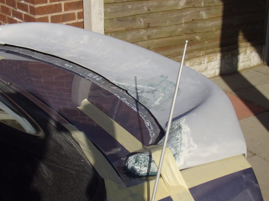

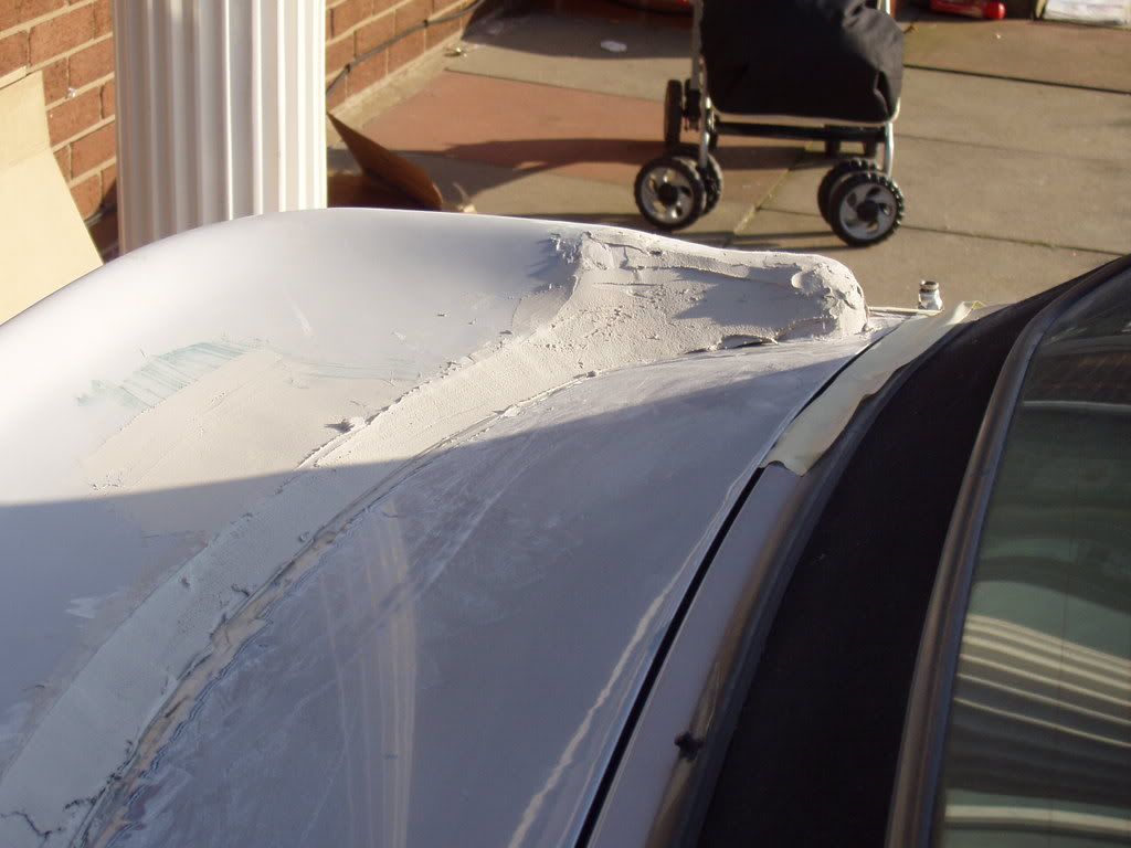

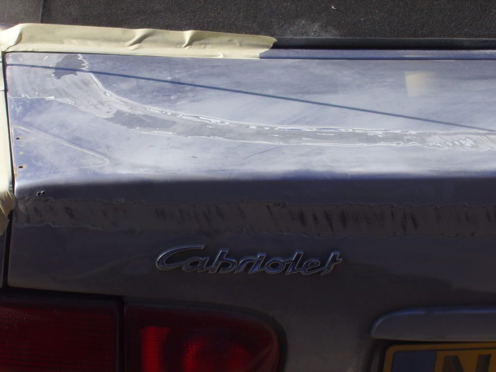

Guest Eggsy Posted February 18, 2008 Share Posted February 18, 2008 Well Brutus was kind enough to give me a cozzi spoiler but it was of a mk5 & didn't fit properly (flatbacked) so I purchased myself 1 off ebay, chopped it & glassed it into some sort of shape - hopefully should be done by the weekend (next! pmsl) PS. not done any bodywork for a while - but if there's any of you girls that need any dints looking @ I'd be happy to oblige!!! FPMSL :happy001: Link to comment Share on other sites More sharing options...

Escort Cabriolet Club Posted February 18, 2008 Share Posted February 18, 2008 Could you post some bigger pics please mate, looks good from what I could see but bigger is better !!! Link to comment Share on other sites More sharing options...
Guest Eggsy Posted February 18, 2008 Share Posted February 18, 2008 ..........i've just discovered you can get them ready made for the cabby thro the EscortEVOClub mind you,........there'd be no fun in just bolting one straight on would there Eric? or you could have gone to esp design they do one for the cabby ! Could you post some bigger pics please mate, looks good from what I could see but bigger is better !!! Yeah have seen them @ mc aswell (I think) but why pay £140 + p&p & then paint when as Brutus said takes the fun out of things & it's something to do + only cost £50 inc p&p (lol) & charlzy if you click on the pics they go bigger bud!! Link to comment Share on other sites More sharing options...
escortcabrioletclub Posted February 19, 2008 Share Posted February 19, 2008 looking good nice to see people trying things for there self ..... also once done drill it and fill with exspanding foam . will help it not to flex and crack paint also will stop it sounding hollow when shuting boot and will cut down vibration hope that helps i do try Link to comment Share on other sites More sharing options...

Guest Eggsy Posted February 19, 2008 Share Posted February 19, 2008 looking good nice to see people trying things for there self ..... also once done drill it and fill with exspanding foam . will help it not to flex and crack paint also will stop it sounding hollow when shuting boot and will cut down vibration hope that helps i do try Might have a go Tony but knowing my luck may get a bit over enthusiastic & pop it off the boot!!! pmsl Link to comment Share on other sites More sharing options...
