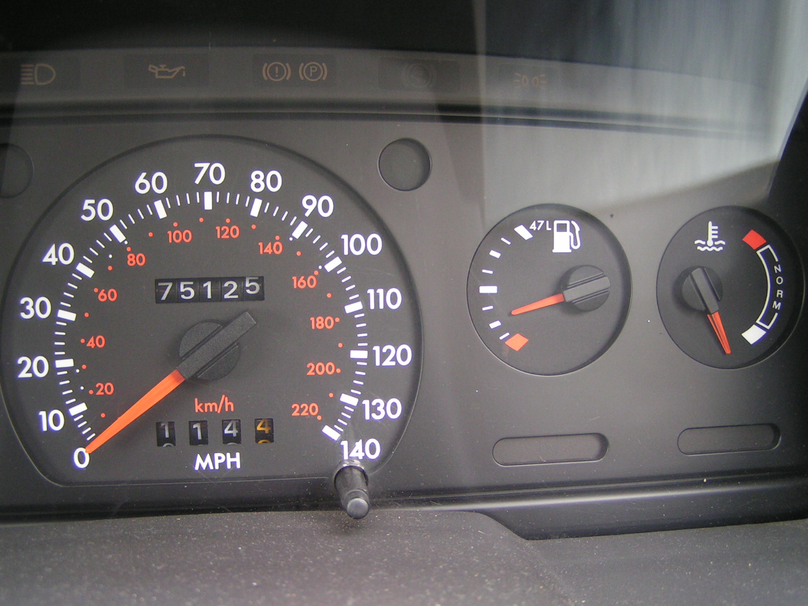

c) In order to ensure the temperature gauge reads minimum when engine is cold (as part of the above problem solving), I had to position my needle so low that when the ignition is switched off the needle falls almost touching the edge of the dial fascia. (I notice there are no stays like with a rev counter and a speedo). Is this normal ?
this i'm not so sure about - mine's quite a long way down but not as far down as yours by the sounds of thimgs. have a look at the attached pic anyway.
glad you got it sorted, i've just had to fix mine again, its still not working right but it'll do til i can afford to do everything else!
