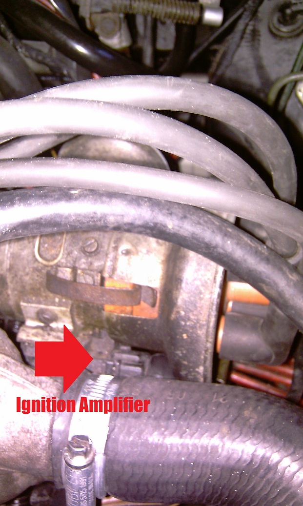

Guest Dojomaster1984 Posted August 23, 2011 Share Posted August 23, 2011 Hi I have a 1.6i CVH running what i think is a Bosch distributor, The thing i dont know is weather the new coil i bought will work. I have got a constant energy coil. But i am not sure if it will work for me. I am getting no spark from the coil, but i am getting 12v on both terminals. So i know i need a non ballasted coil. acording to the website i bought the coil from, the only coils available for the MK3 escorts are constant energy types. So when it comes down to it. WHAT DAMN COIL DO I NEED Quote Link to comment Share on other sites More sharing options...

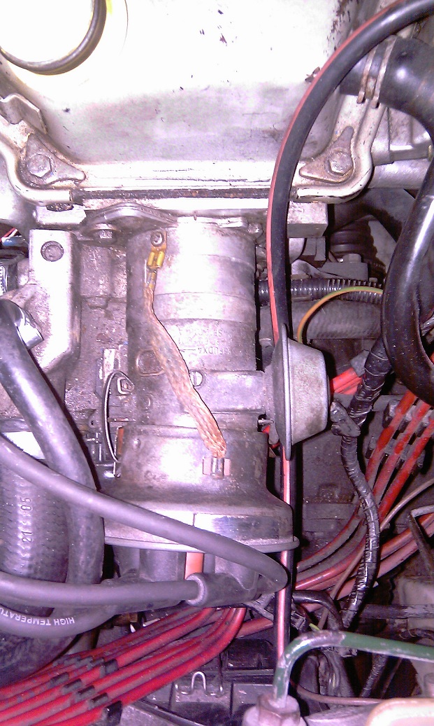

Guest Dojomaster1984 Posted August 23, 2011 Share Posted August 23, 2011 Distributor Quote Link to comment Share on other sites More sharing options...
Guest El87cabi Posted August 23, 2011 Share Posted August 23, 2011 (edited) well your dizzy looks the same as on my old mfi lump, so i'd guess the coil was the same, need to see a picture to be sure, if it is i've got 2 or 3, 1's genuine ford i think. hope that helps el Edited August 23, 2011 by El87cabi Quote Link to comment Share on other sites More sharing options...
Guest Dojomaster1984 Posted August 23, 2011 Share Posted August 23, 2011 Yep on a MFI setup and i even have the one wierd double wire clip hanging lose next to the meter head that is meant to connect to the distributor, BUT WAS NEVER CONNECTED. I have a coil already. I just need to make sure that i can use this CONSTANT ENERGY type. Quote Link to comment Share on other sites More sharing options...
Guest El87cabi Posted August 23, 2011 Share Posted August 23, 2011 Well there's nothing special about the coil, if you've got a new 1, its the correct type according to where you got it from it should be right. If you've put it on, connected it to the dizzy and there's no spark then its probably the dizzy or module on it is gone, not the coil. Quote Link to comment Share on other sites More sharing options...
