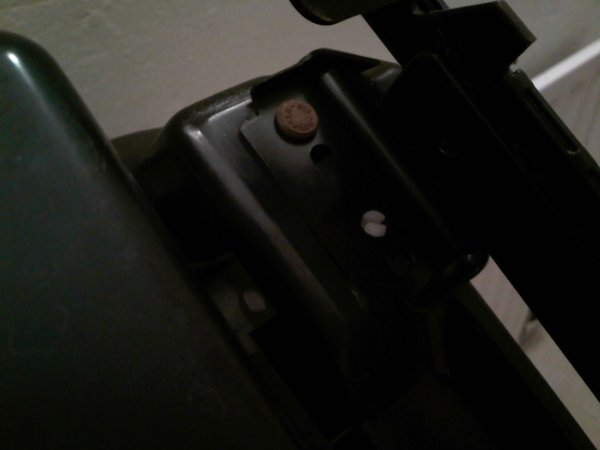

hi all me again,,,,,bit of help realy,,,iv got hold of a mint set of seats for my cab,,how ever they dont fit :mad: the sub frames are completely diffrent,,then i relised the seats were out a mk6,,,so does any one know if they can be alterd(not bodged)to fit my mk5 cabby
You may be able to fit the mk5 runners to the mk6 seats if there's enough room for adjustment under the mk6 seats. I would grind off the heads of the mounting studs then fit new nuts and bolts to the runners when mounting on the newer seats. Do one seat at a time so you have references for measurements.
