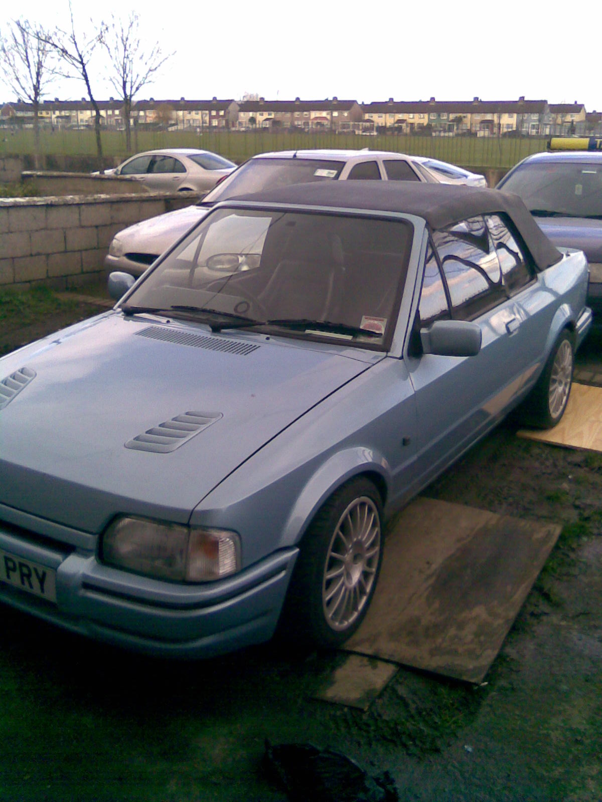

Guest Admartin Posted April 15, 2010 Share Posted April 15, 2010 Can anyone help me ive an 1989 escort xr3i im having a problem with the fuel line or fuel pump basicly if i spray Carb Cleaner in2 her she starts straight away but otherwise there seems to be no fuel coming down the line and she just wont start,Any1 tell were exactly the fuel pump is in this model and any advice would be much appreciated cheers Miss Adrienne Quote Link to comment Share on other sites More sharing options...
Admin Paul Posted April 15, 2010 Admin Share Posted April 15, 2010 Is it a EFI or MFI ? EFI pump is in tank MFI pump is on bracket next to tank Quote Link to comment Share on other sites More sharing options...
Guest Lee81 Posted April 15, 2010 Share Posted April 15, 2010 Could be many things causing that. Would see if pump can be heard running. Pink relay that powers it often burn. out. Pump is on bracket next to tank as said before. You'll be able to see it from the rear. Quote Link to comment Share on other sites More sharing options...
