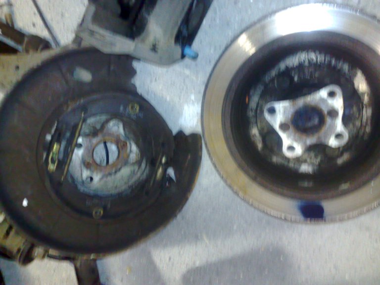

Guest SteveB Posted January 20, 2009 Share Posted January 20, 2009 Bit confused at this, as they do infact use drum brakes inside the disc? yeah they confused me first time i saw them very similar to bmw's 325i rear disks with the drum inside theses are my rear disks in bits the day i discoverd i had a similar issue Link to comment Share on other sites More sharing options...
Guest MCBob Posted January 20, 2009 Share Posted January 20, 2009 They look exactly like RS2K discs. Make sure youre asking for 91-95 mk5 escort discs, as later had drums. Link to comment Share on other sites More sharing options...
