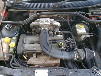

Guest billena Posted August 24, 2008 Share Posted August 24, 2008 ok i think im opting for engine swap i can get hold of a mk6 1996 tin top.. its had a 2ltr (2000yr) mondeo engine with a rs2000 full exhaust im hoping i can tack this out and put in my mk5b 1994 cab... if i do a full transplant engine/gearbox whould i need to change the ecu/loom of will it fit strait in????? THANKS FOR ALL THE HELP :icon_salut_gb: IVE ADD PIC OF THE DONER LOL Link to comment Share on other sites More sharing options...
