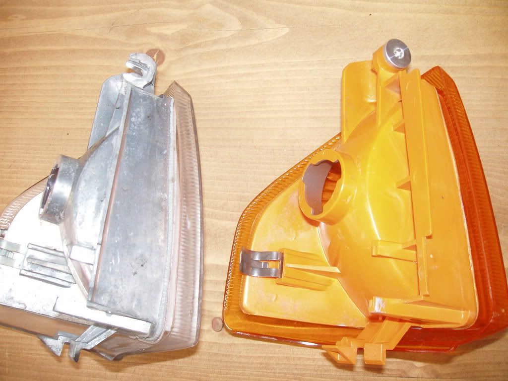

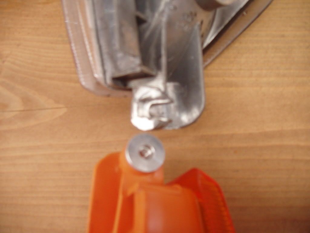

Guest Blackbess Posted April 20, 2008 Share Posted April 20, 2008 I have just bought some new orange indiactors and went to fit them today, but the fitting is totally different to the ones I have in, although they are the same shape! See pictures below: Not sure whats happened or what I can do about it. Is there something that I can get or make that will convert my current fitting to the screw type? Thanks Trace Link to comment Share on other sites More sharing options...
Guest Dazzaas Posted April 20, 2008 Share Posted April 20, 2008 if i remember right the orange ones are original fitting the bolt that holds headlight in screws into indicator that was factory fit type Link to comment Share on other sites More sharing options...
Guest ANDYA Posted April 20, 2008 Share Posted April 20, 2008 Totally right Daz, all you need is the small bolt Bess. Andy Link to comment Share on other sites More sharing options...

Guest Eggsy Posted April 21, 2008 Share Posted April 21, 2008 Trace, they're definatly MK3's - you should have a bracket that comes out from behind the headlamp adjustment on the headlight that slots into the indicator, push in it @ the top & then it clips in @ the bottom, the top is screwed in & if my memory serves me right it should be like a rounded nut that I then think the headlight then sits into. Tbh you would probably be best to remove the headlamps 1st to fit the indicators as I'm sure that there's a little sort of wedge allong the inside of the indicator that sits behind the headlight. Hope this helps Eggsy Link to comment Share on other sites More sharing options...
