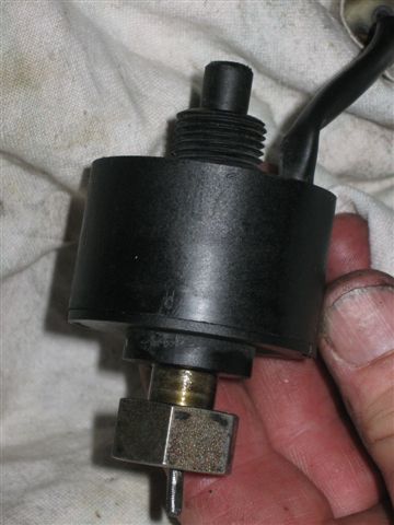

Guest Stephen Posted February 6, 2011 Share Posted February 6, 2011 The black bit you have described is the speed sensor, this sends road speed information to the ECU and just unscrews fron the gear box. (sorry didn't realise you had one of those!) The bit I was decribing is the bit under that which houses the speedo drive. I know there isnt much room but it can be done from up top without removing the ABS modulators. Good luck Hi, Thanks for your advice back in early December. The new lower speedo cable final arriveb from FORDPARTSUK.COM (Edwards Ford) just before Christmas. Next weekend we have multi-car club Classic Car Weekend with car runs to various reserves/parks around Auckland so I decided to fit the speedo cable and get the certificate of fitness for the car issued so we car drive in one of the runs. I'd appreciate some more advice as I don't want to break any thing - repacement parts for the car are not readily available in New Zealand as the only models in the country have been privately imported as used vehicles. Yesterday I was able to remove the black speed sensor from the gear box without much trouble - see pic. The new lower speedo cable does not have a speed sensor attached to it. Have I been sent the wrong lower speedo cable or do I have to remove the broken square drive which is located in the top end of the speed sensor and has broken off flush with the top of the speed sensor? There is a square drive pertruding from the lower end of the speed sensor - when this is spun, the broken square drive that has broken off flush spins so the 2 ends are either 1 piece or 2 pieces connected. Using pliers I tried pushing the square pertruding drive upwards and expected to see the broken off flush bit pushed out - this didn't happen. Does the male square drive end of the new lower speedo cable (see attached pic) therefore slide into the top of the speed sensor unit once the broken piece has been removed? Regards Stephen. Quote Link to comment Share on other sites More sharing options...
Guest richie29gt Posted February 6, 2011 Share Posted February 6, 2011 hi the square drive bit at the bottom of the speed sensor is part of the speed sensor the bit of the speedo cable in the top will come out but will have alot of drit in it thus making it hard to remove so try sum penetrating fluid in it sumthing like wd40 to loosen the dirt u will find it is just under a inch long, and when u do remover the new cable is ready to be put in place in ur second pic is how it should be but a bit of advise every 6months get sum oil/lube and put it down the speedo cable to stop water building up and causing said problem agen hope this help rich Quote Link to comment Share on other sites More sharing options...
Guest Stephen Posted February 7, 2011 Share Posted February 7, 2011 hi the square drive bit at the bottom of the speed sensor is part of the speed sensor the bit of the speedo cable in the top will come out but will have alot of drit in it thus making it hard to remove so try sum penetrating fluid in it sumthing like wd40 to loosen the dirt u will find it is just under a inch long, and when u do remover the new cable is ready to be put in place in ur second pic is how it should be but a bit of advise every 6months get sum oil/lube and put it down the speedo cable to stop water building up and causing said problem agen hope this help rich Hi Rich, Thanks for your advice. Regards Stephen Quote Link to comment Share on other sites More sharing options...
