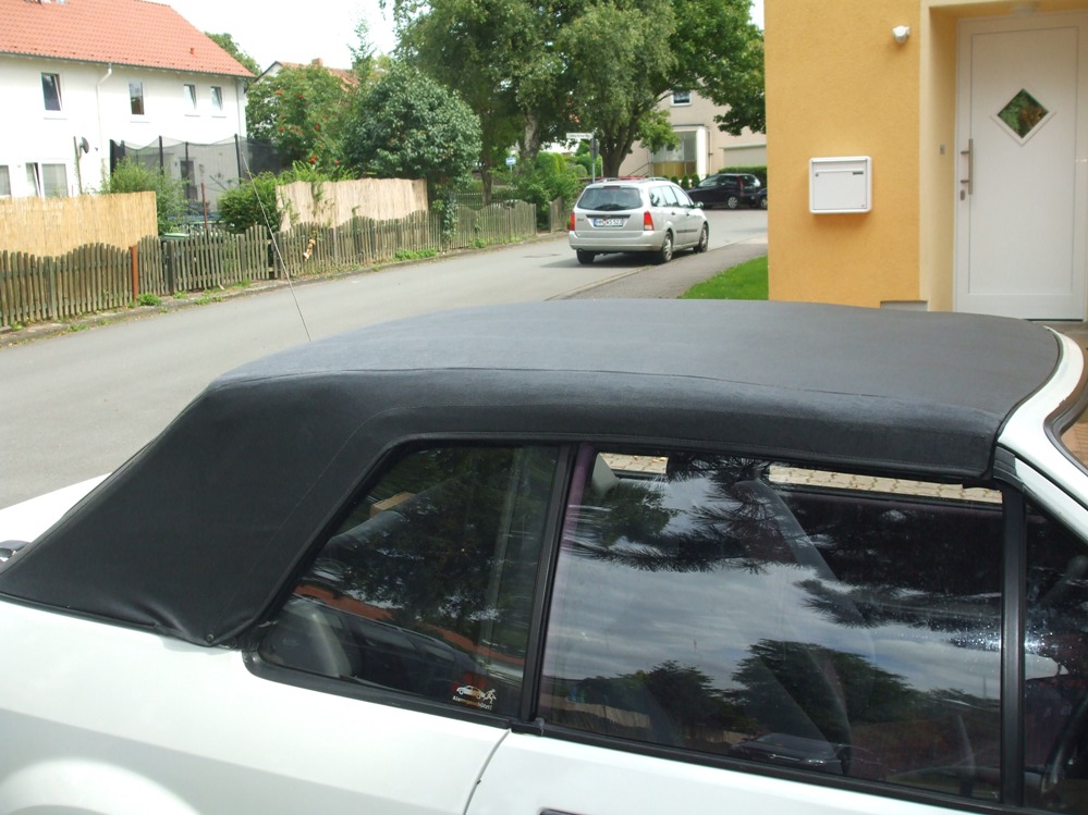

Guest wildsquaddie Posted August 9, 2009 Share Posted August 9, 2009 Hi, Pics of my diy new roof outer. Not a bad result for a first effort!!!!!!!!!!!!! Quote Link to comment Share on other sites More sharing options...
