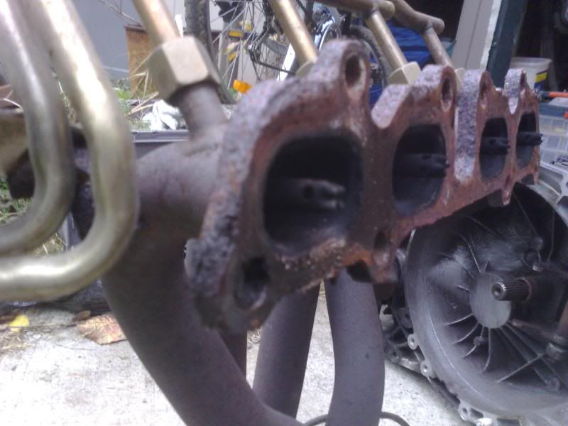

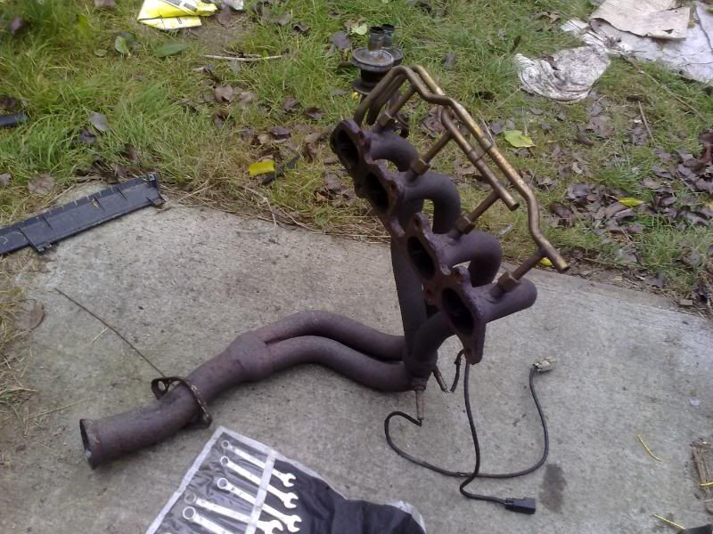

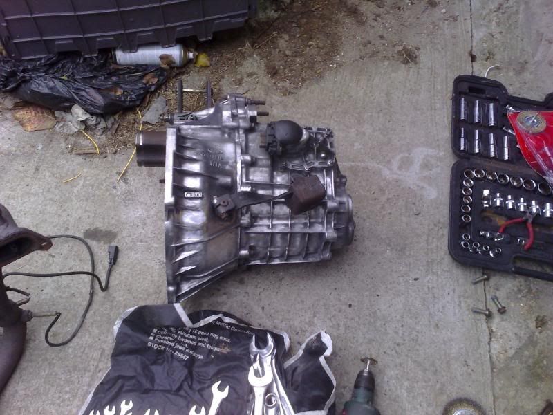

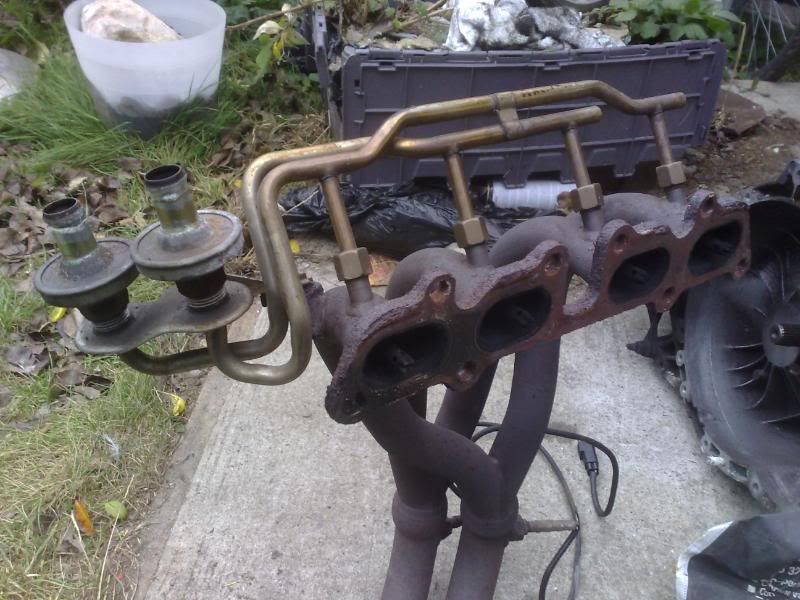

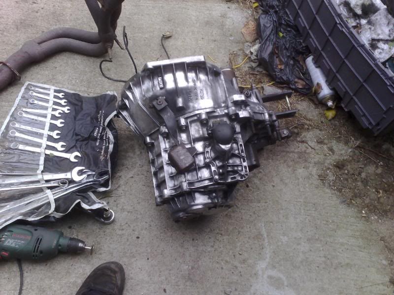

Guest markeyboy Posted October 5, 2008 Share Posted October 5, 2008 thanks for the comments guys im done with the box now, really fed up of polishing etc this is how it is had a go at removing the air pulse system, only half done on this so no after pics yet, having a few issues getting the internal pipes off. Quote Link to comment Share on other sites More sharing options...
Guest steelcabby Posted October 5, 2008 Share Posted October 5, 2008 Gearbox looks great mate, alot better than it was anyway. oh and if you go onto www.rs2000-16v.com there are some really good ideas and tips. there is a bloke on there that does the modified exhaust manifold ported and strengthened etc for £100. or if your stuck on anything that is the best place for help. there are some really good folk on there Quote Link to comment Share on other sites More sharing options...
Escort Cabriolet Club Posted October 5, 2008 Share Posted October 5, 2008 Gearbox looks good mate, puse air system looks a bit rude lol, but after seeing your Reliant pics i'm sure it will look a lot better in no time !!! Quote Link to comment Share on other sites More sharing options...

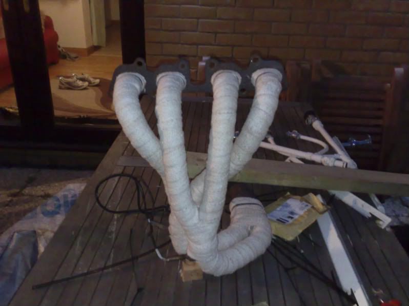

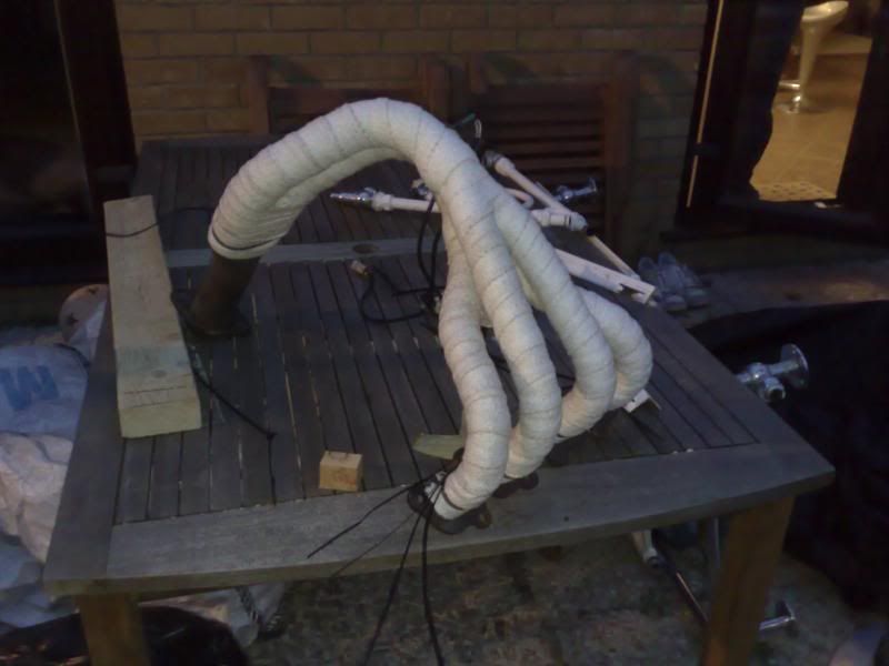

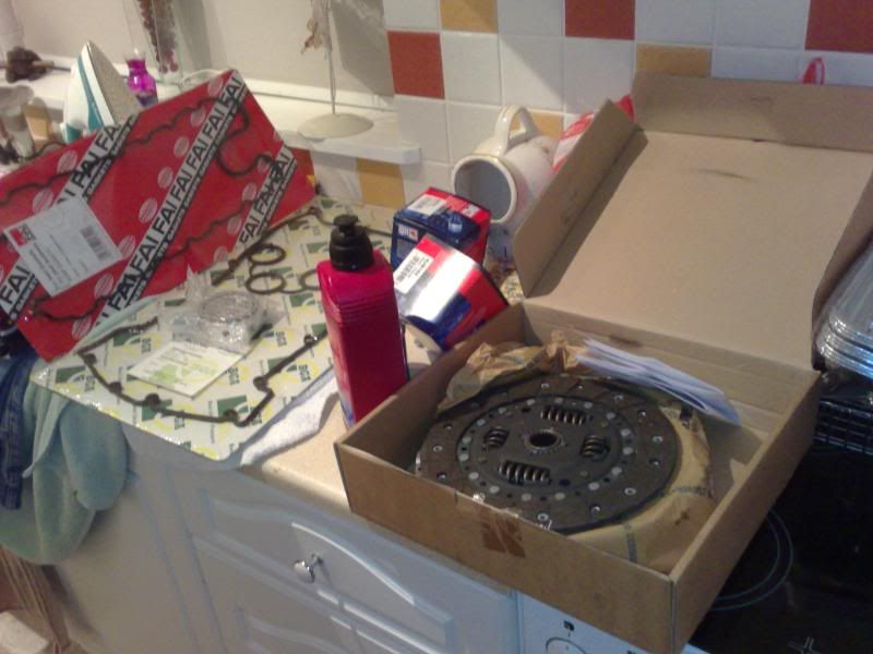

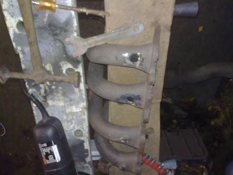

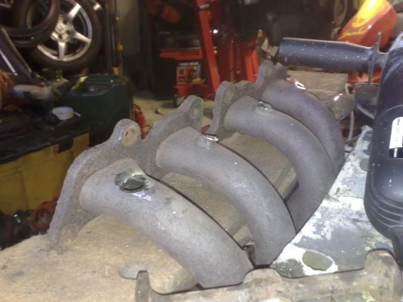

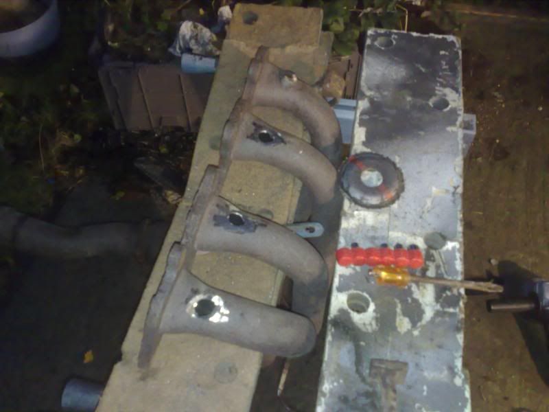

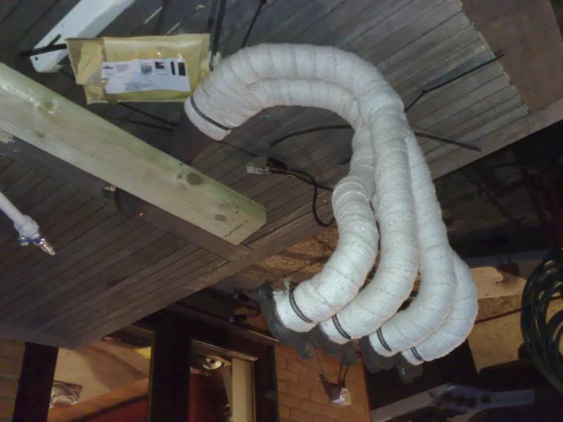

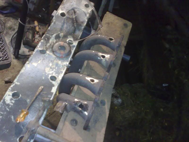

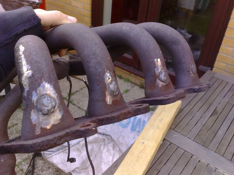

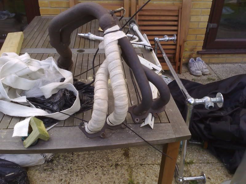

Guest markeyboy Posted October 23, 2008 Share Posted October 23, 2008 its been a while and an update is well overdue, so here it is been spending some money, got exhaust, rocker cover and sump gaskets, new cv boots, new clutch. and a few other bits n bobs the exhaust is now finished, welded up and heat wrapped heres a few progress pics so theres all the holes heres it welded up and here is the manifold half wrapped - its all finished now and to be honest looks fooking awsome!! ill add the finished pic tonight while that was away at the welders i decided to have a play with somthing else this is still a work in progress Quote Link to comment Share on other sites More sharing options...

Escort Cabriolet Club Posted October 23, 2008 Share Posted October 23, 2008 Looking good mate !!! How come you had to weld the manifold ??? Quote Link to comment Share on other sites More sharing options...

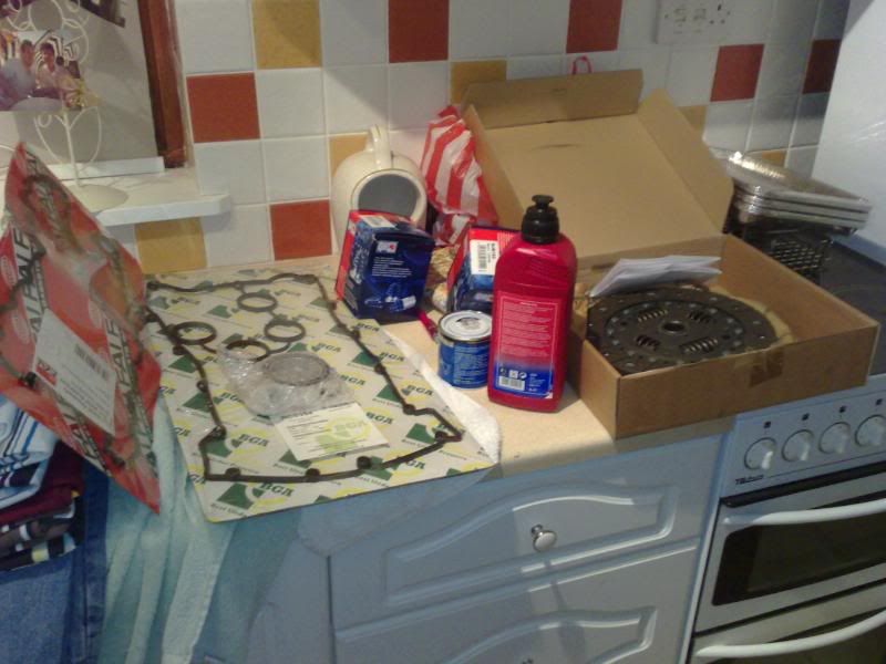

Guest markeyboy Posted October 23, 2008 Share Posted October 23, 2008 (edited) eggsy it aint done yet, charlzy - got the exhaust welded up b cos there were holes where the air pulse system was removed there we go all finished and my shopping, 1 clutch, 2 inner cv boots, sump gasket, rocker cover gasket, oil filter sandwich plate for my oil temp and pressure gauges, engine paint and a 1 litre bottle of trans fluid (cos the sump plug from my gearbox came undone and emptied itself lol) Edited October 23, 2008 by markeyboy Quote Link to comment Share on other sites More sharing options...

Escort Cabriolet Club Posted October 24, 2008 Share Posted October 24, 2008 Got some goodies there mate !!! What was the Pulse Air system ??? Quote Link to comment Share on other sites More sharing options...

Guest markeyboy Posted October 24, 2008 Share Posted October 24, 2008 thanks guys coming on nicley mate, can't wait to see it done, your be well chuffed with the lump i hope so mate, Got some goodies there mate !!! What was the Pulse Air system ??? somthing to make the cat heat up quicker to get the emmisions down to the correct level quicker, apparently it causes a bit of a restriction in the exhaust, so it had to go Quote Link to comment Share on other sites More sharing options...

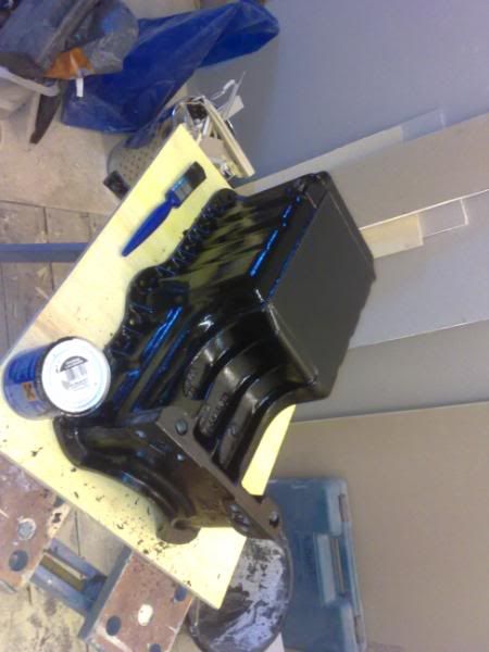

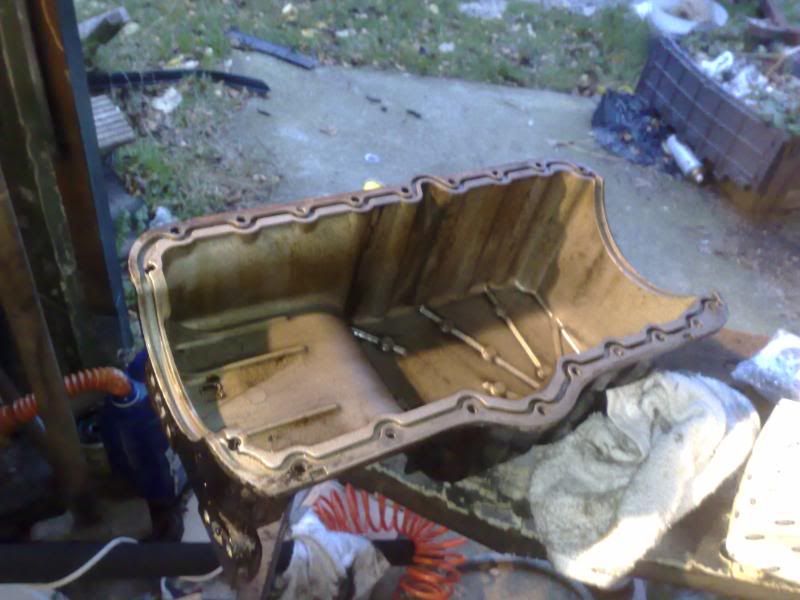

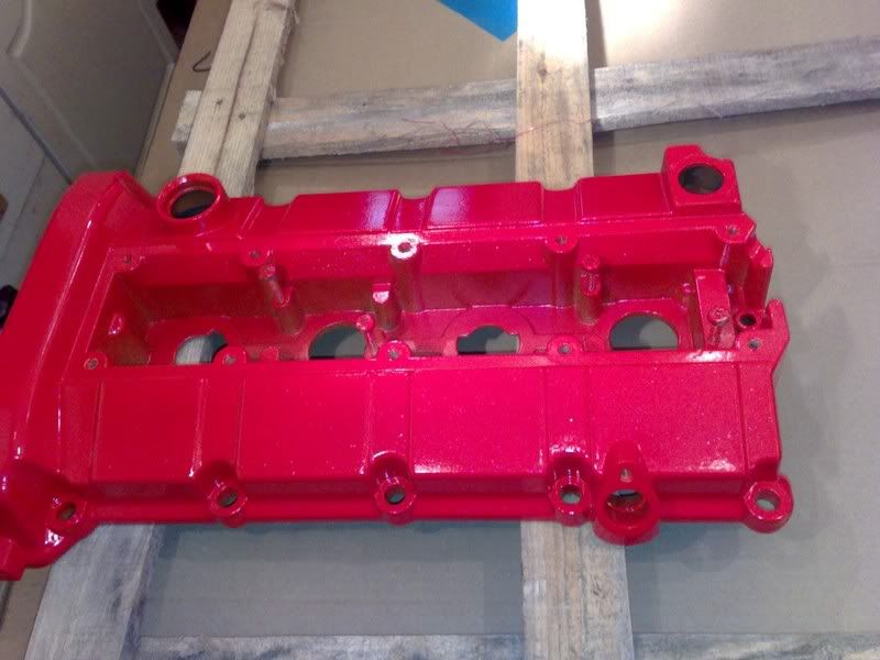

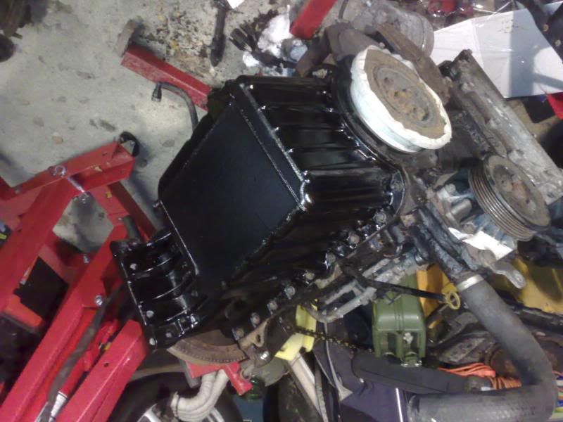

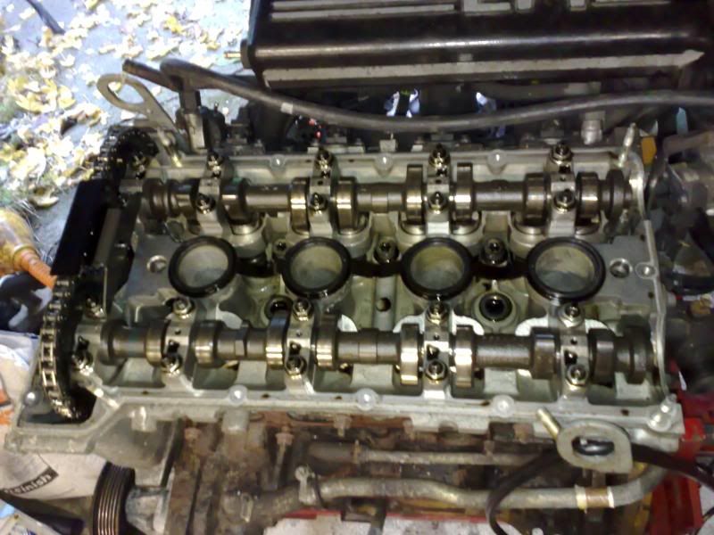

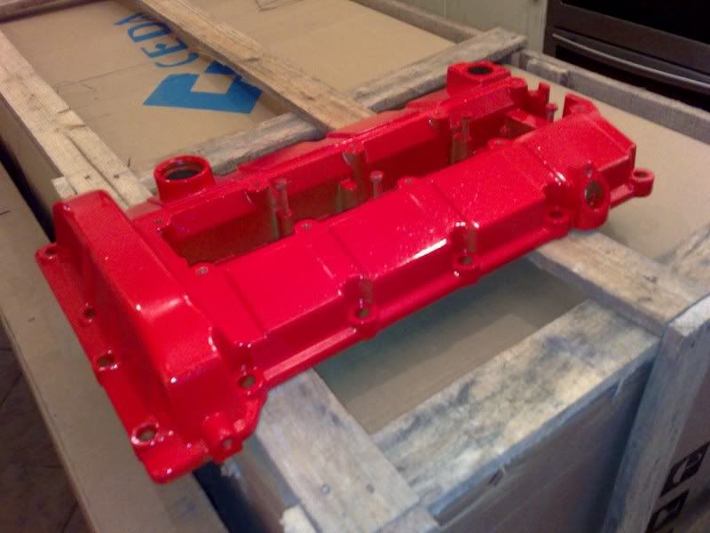

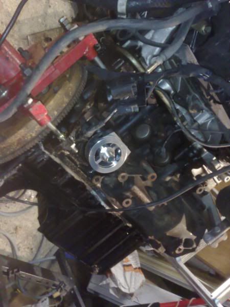

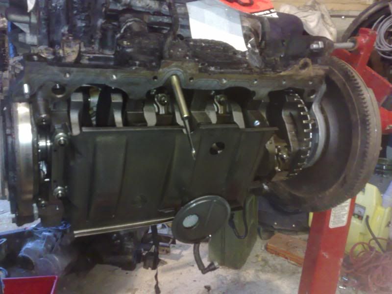

Guest markeyboy Posted November 12, 2008 Share Posted November 12, 2008 getting there fella. let me know if u need a hand wiv enething cheers mate, done a little bit this week, took the rocker cover off (guna give it a coat of paint but not to sure which colour yet) in the process one of the bolts snapped off (another pain in the arse to sort) painted the block and sump tis afternoon i hope to get the sump bk on, oil filter n sandwich plate, i may even try to fit the clutch depending on how i feel i will have some pic updates soon Quote Link to comment Share on other sites More sharing options...
Guest markeyboy Posted November 12, 2008 Share Posted November 12, 2008 when i took the rocker cover off pretty clean eh! nice painted sump Bottem end new sump gasket sump Sump on oil sandwich plate on oil filter is now on thats it for today, didnt get the clutch on today, thats the next step Quote Link to comment Share on other sites More sharing options...

Guest markeyboy Posted November 22, 2008 Share Posted November 22, 2008 cheers mate, theres been a little more work done, i owe jonny b a big thank you for this one take a look red with blue n sliver glitter, was hoping to get a bit more work done on the engine today, but have been doing alot of electrics indoors insted. Quote Link to comment Share on other sites More sharing options...

Escort Cabriolet Club Posted November 23, 2008 Share Posted November 23, 2008 That looks sweet mate, going to stand out against the dark paint of the Cab !!! Quote Link to comment Share on other sites More sharing options...

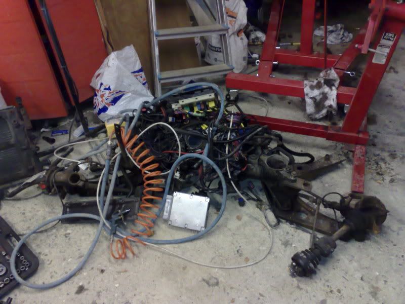

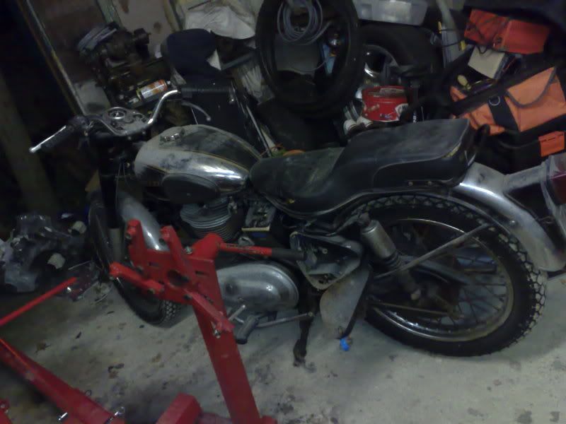

Guest markeyboy Posted November 27, 2008 Share Posted November 27, 2008 a little more progress and a bit more room in the garage, this has now gone to a new home, the guy has only had it 2 hours n he has already got the old girl running we had it for over 7 years n it ran once lmfao - somone with the time n the knowledge ehh have sorted this pile of bits out so i now know roughly what i got more to come after i eat my dinner lol Quote Link to comment Share on other sites More sharing options...
