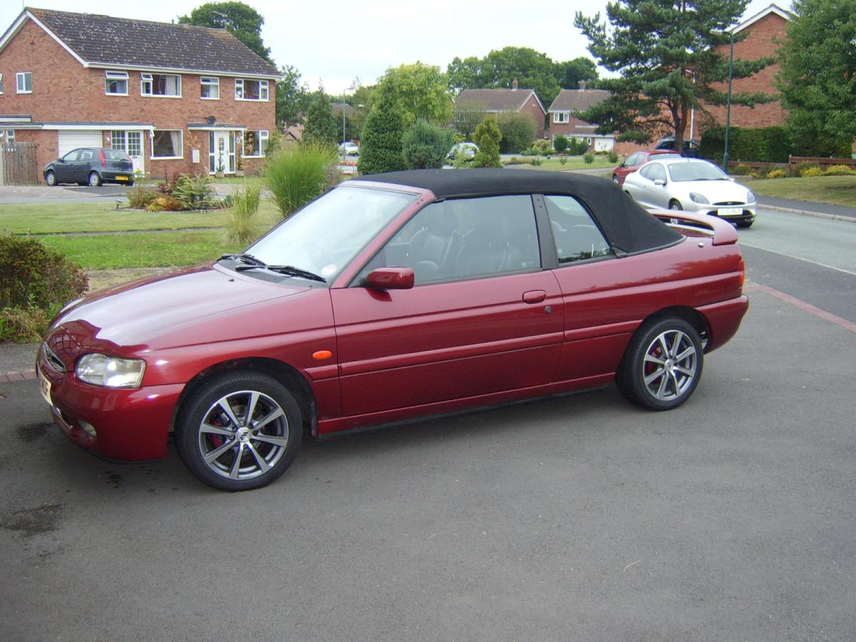

Guest Tatty Taylor Posted July 17, 2012 Share Posted July 17, 2012 Greetings.. My mark 7 is currently running on 195/50/15 tyres(legal limit), have just been handed a set of 4 (7mm tread) 195/55/15. Can anyone tell me if there will be any major issues with me fitting these.I believe the 55 is the height of the tyre so am i correct in assuming the only issue will be cosmetic. Any advice would be useful. Thanks Mark(Tatty) Quote Link to comment Share on other sites More sharing options...
Guest black xr3i Posted July 17, 2012 Share Posted July 17, 2012 is it on dropped springs? cus if it is then yer need to roll the arch lip jus a bit Quote Link to comment Share on other sites More sharing options...
Guest Tatty Taylor Posted July 17, 2012 Share Posted July 17, 2012 is it on dropped springs? cus if it is then yer need to roll the arch lip jus a bit your worrying me now..... i think everything is original.!!!!!!! Quote Link to comment Share on other sites More sharing options...
Guest black xr3i Posted July 17, 2012 Share Posted July 17, 2012 shouldnt have any probs then if on standed springs ....the 195 is the width....55 is hight of side wall ...and 15 is the inch of rim so ur only goin up by 5 so should be ok Quote Link to comment Share on other sites More sharing options...
Guest Tatty Taylor Posted July 17, 2012 Share Posted July 17, 2012 shouldnt have any probs then if on standed springs ....the 195 is the width....55 is hight of side wall ...and 15 is the inch of rim so ur only goin up by 5 so should be ok thats what i thought.. but sometimes its easy to miss the obvious ..... now to get them fitted!!!!!!!!Thanks for help Quote Link to comment Share on other sites More sharing options...
gingergman Posted July 17, 2012 Share Posted July 17, 2012 55 would be fine even on a lowerd Quote Link to comment Share on other sites More sharing options...
Guest Tatty Taylor Posted July 18, 2012 Share Posted July 18, 2012 55 would be fine even on a lowerd :banana_dance: Thanks..... Quote Link to comment Share on other sites More sharing options...
Nadab Sardar Posted July 21 Share Posted July 21 Going from 195/50/15 to 195/55/15 is a really minor change and, as others have said, you'll be absolutely fine. Quick breakdown for anyone unsure on the numbers: 195 = tyre width (mm) 55 = sidewall/profile height (as a % of width) 15 = rim diameter (inches) You're only stepping up 5 points in profile, so the overall rolling diameter increases slightly nothing that'll cause rubbing or clearance issues if the car's on standard suspension. On stock springs, 195/55/15s will sit and drive just fine, no MOT or legal concerns either. The only thing to watch is if the car's been lowered in that case, you might get a touch of rubbing on full lock or over bumps, and rolling the arch lip slightly sorts that out. But since you've said everything's standard, you shouldn't need to touch anything just get them fitted and enjoy the slightly plumper sidewall (a bit more cushioning over rough B-roads and speed bumps, which plenty of MK2 Cabriolet owners actually prefer). Nice find on a set with 7mm tread left too good result. Quote Link to comment Share on other sites More sharing options...
