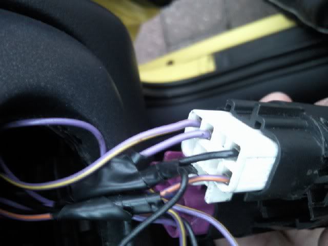

Guest swampy83 Posted November 10, 2009 Share Posted November 10, 2009 Right want to check with the people that know Does the rear fog light on the mk6 have a relay? If so does anyone have one? the reason I ask is that my fog light has power but does not stay on when switched on I've tried 3 switches and it not the switch I can only think of some relay but I can't find it any idea where it is All help gratefully received Quote Link to comment Share on other sites More sharing options...
Guest Cabbytech Posted November 10, 2009 Share Posted November 10, 2009 I will check on mine for you tomorrow, but i believe it does have a relay, Quote Link to comment Share on other sites More sharing options...
Guest Cabbytech Posted November 11, 2009 Share Posted November 11, 2009 Ok, i cant find a relay for the rear foglamps, but the front ones have one, I have taken the following pic of my switch for you to compare with your own, Violet wire...should go to F1 rear fog lamps 10A fuse. Violet/yellow...directly to rear foglamp. Violet/Orange...this wire doubles up with the Violet/Yellow wire to the front fog lamp switch which also goes to the side/headlamp switch and then goes to F11 control lights 10A fuse. Black wire...goes to earth. hope this helps you mate. Quote Link to comment Share on other sites More sharing options...
Guest swampy83 Posted November 20, 2009 Share Posted November 20, 2009 Cheers dude all the cables are all right but it still not staying on Quote Link to comment Share on other sites More sharing options...
