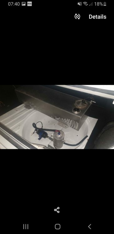

Lift the back seat base and pull the pump plug not the sender which is the strange shaped one  then fire a live and earth straight to the pump cable and have a listen see if its the pump
Saves dropping the tank,ive just took my new tank and new efi pump off and fitted a fuel cell in the boot as i never had power via the plug so ran my own power instead
Del
