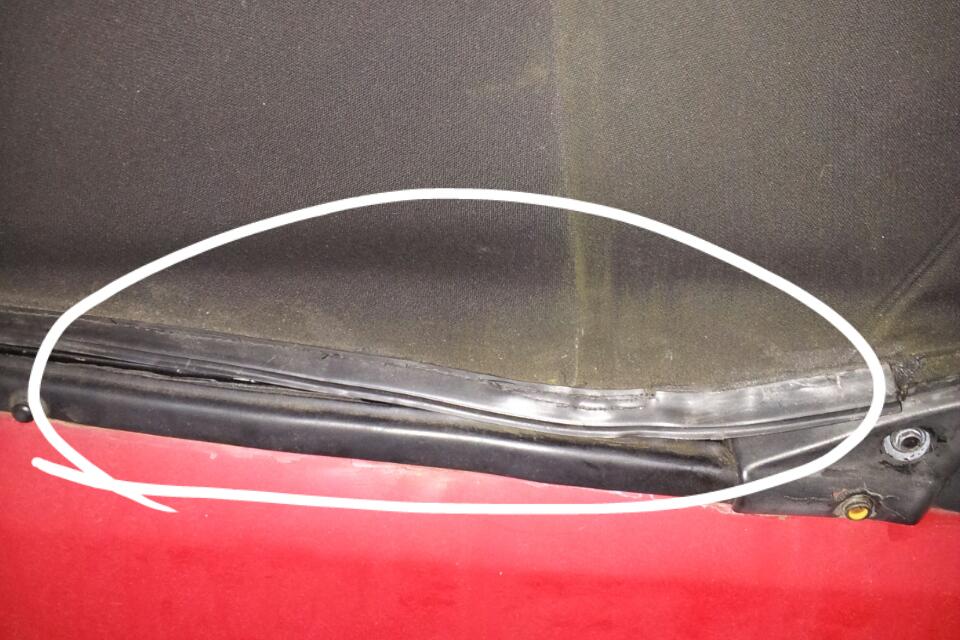

Guest spitfire72 Posted April 11, 2013 Share Posted April 11, 2013 I have just purchased my friends cab and it has recently been tampered with regarsding ifs roof. On the left and right side they have lifted the roof away and ouf of its seals and i was wondering if this was easy to fix. Its the part thats meats the bodywork just behind the rear quarter windows. I ha e photos if anyone wantts a look closer. Thanks. X Quote Link to comment Share on other sites More sharing options...

Guest spitfire72 Posted April 11, 2013 Share Posted April 11, 2013 (edited) The other side Edited April 11, 2013 by spitfire72 Quote Link to comment Share on other sites More sharing options...
Guest Mattyboy Posted August 19, 2013 Share Posted August 19, 2013 I don't think new seals are going to help you. I had the same issue on mine and it was because the metal flange that is supposed to hold the rubber in place had rusted away. Take the seal off and I'll bet there's rusty metal behind there. You need to clean the rust and then paint it, if its really bad you'll need to replace the rusted metal. You may need to use some adhesive to get the rubber seal to stay on as we'll. Some black silicone sealant was good enough for me. Quote Link to comment Share on other sites More sharing options...
